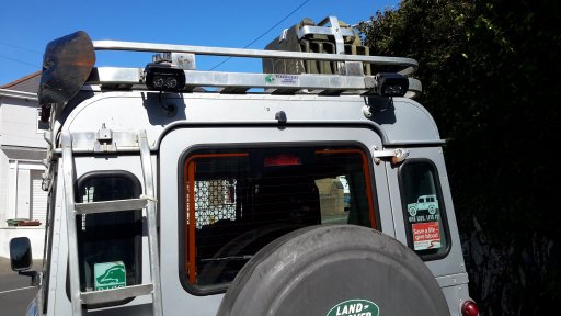

I fitted Nolden headlights to my Defender. Although theyre a massive improvement on the original Land Rover lights I'm not actually that impressed. I know they have upgraded the Nolden but I don't know how much better they are from their initial lights.
I make up with my fair share of extra lights, 1 x Lazer Triple R28, 2 x Lazer Triple R 750 Elite and 2 x Lazer ST 4. on the back I have 2 x Lazer ST2 for reversing and setting up camp
