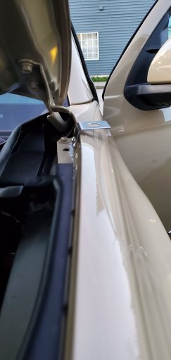

That doesn't look like a good tie into the vehicle body for a good ground. I would be leery of it. Plus you'll need to remove all the paint from both your antenna mount and ditch light bracket at the contact points to make sure you have good RF continuity.
Will this be fine for a GMRS radio? I literally bought the same ditch light bracket mount (and a little "ghost" antenna to go with it) directly from Midland's website, and they feature a very similar picture. I assumed (maybe mistakenly) that if they sell one for the radio, the setup should work fine! But of course different bands.
The Rago mount would work fine with a 1/2 wave 2m antenna as it doesn't require a ground plane, however for other antennas that do you would have to remove much of the powder coating from the antenna bracket and the ditch light bracket in multiple places.
You could also go with a fender mount instead of the ditch light or hood lip mount for a better ground.
The generic L brackets are much cheaper.

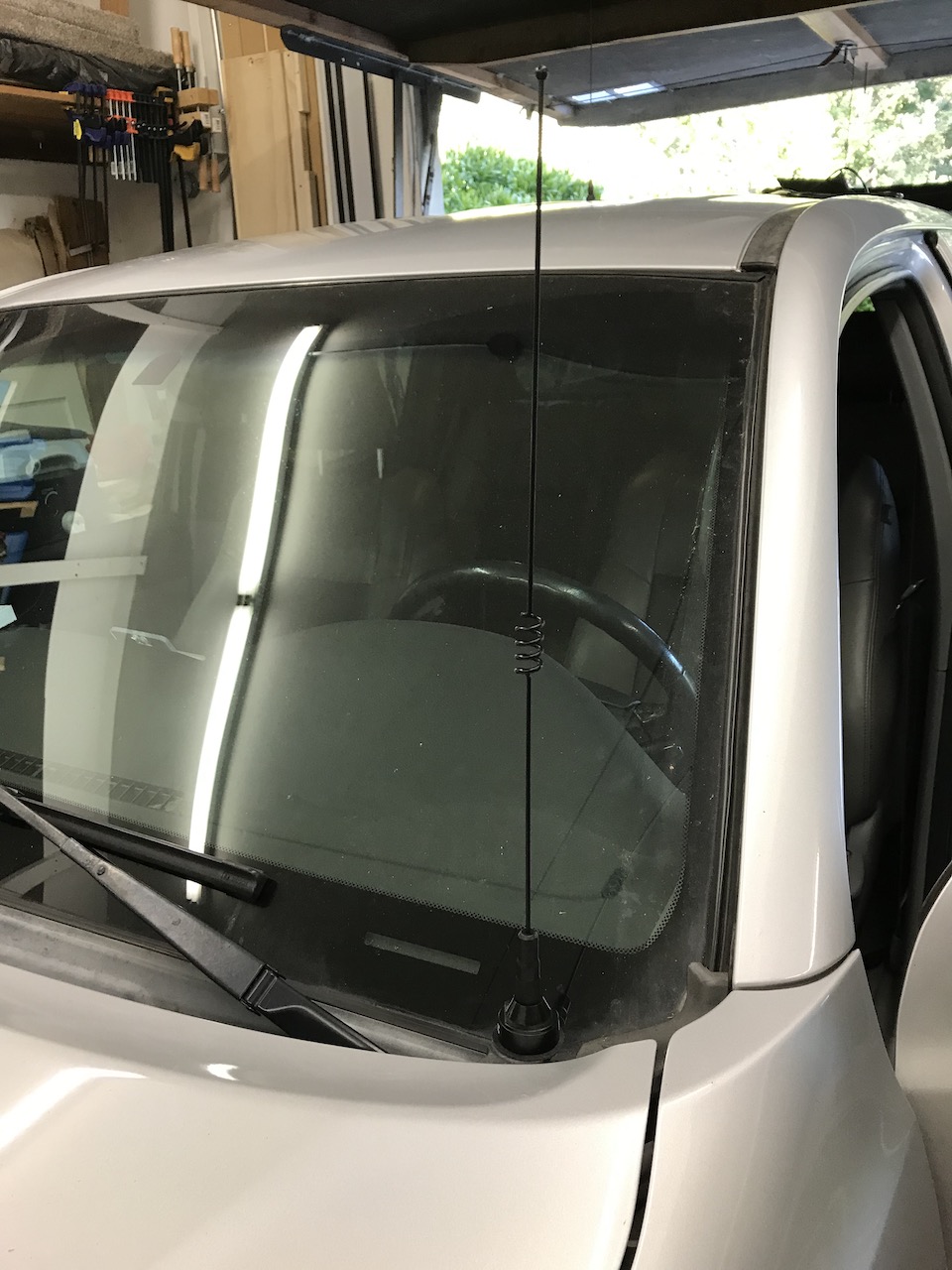

I just did a similar install on my 2nd gen Tacoma, except that the antenna is mounted directly to the "ditch light" bracket. On my install I used an NMO mount and ground off some paint where the NMO clamp touches the bracket and also where the bolts contact the bracket to hold it to the hood. I re-sealed both places afterwards to prevent rust. I then used a multimeter and confirmed very low resistance (tenths of an ohm) between the antenna and the negative battery terminal. And yes, the concern is not with a low resistance connection to the battery and is instead in establishing a good ground plane, but I figure if the ground connection was good then it means the connection to the chassis and hood is solid. I also bought an NMO to 3/8" stud adapter so I can put a CB antenna on the same mount and was able to achieve a SWR of below 1.5.
Ultimately I will likely put an NMO mount on the roof where the satellite radio antenna is currently since I don't like the idea of transmitting at 50w so close to my face. But, this hood mounted setup is working great for now and I usually run lower power anyway.

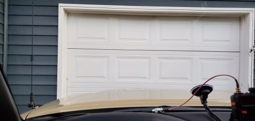

Got the bracket mounted today and test fit the antenna. Things look pretty good for the moment. Once I find my multimeter and soldering iron I will get the cable routed and connector mounted. Looking at where its mounted, I'm curious what kind of power people with similar setups are running? That seems a little close for me to be running a full 50 watts. Is that something I should be concerned with?
I've had that kind of arrangement in the past. If you think about it, you transmit very little compared to listening time. My current rig has three roof mounted antennas, but I'd consider a cowl mount again if I had a roof rack.
