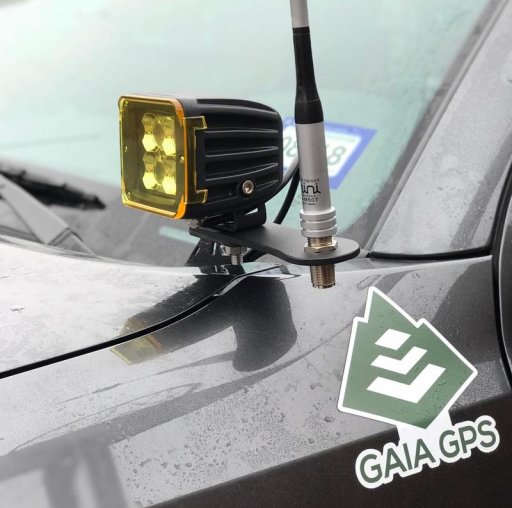

I finally found and ordered my mobile radio and have been looking at antenna mounting options. In my search for ideas I ran across this product from Rago:
I am going to be fabricating new ditch light brackets when the weather gets nicer and was considering building an antenna mount into one side anyway, but something like this would be much simpler to build since I already have the leftover bar stock from previous projects. Has anyone run something like this before and if so did you have any issues with antenna tuning? Would I be better off getting a lip mount for the hood? Any thoughts or recommendations would be appreciated. Thank you.

That doesn't look like a good tie into the vehicle body for a good ground. I would be leery of it. Plus you'll need to remove all the paint from both your antenna mount and ditch light bracket at the contact points to make sure you have good RF continuity.

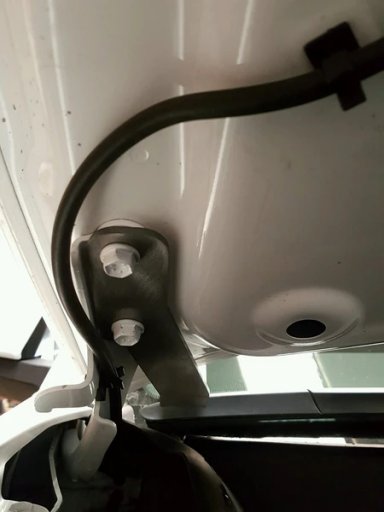

That's what I was thinking would be necessary. Would taking paint off the underside of the hood where the bracket mounts be necessary as well? I would be fabricating these myself so I wouldn't even screw with paint at the contact points.

It would be best, yes. Also you could use tinned copper braid straps to connect it to the body. That way you'd only have to make sure the surface was bare under the connection points of the braid straps rather than stripping a larger area where the bracket contacts the body.

That was something I had considered as well. Please forgive me for my limited knowledge, but the goal on going that route is to keep the strap as short as possible, correct?

Yes. You'd want the strap running from the bracket to the nearest body bolt with good metal to metal contact on both ends of the strap. A little copper anti-seize applied to the contact area will help seal out moisture and the anti-seize is conductive so it also helps provide a good ground. DX Engineering provides the Loc-tite brand copper anti-seize with most of their grounding systems so that's what I've always used on my connection points both on my vehicle and around the house.

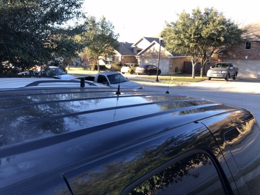

You could always bite the bullet and mount one on the roof. If your concerned about height, there are options available. The two closer antennas are both dual band 2/70 units. The stubby is about 4 inches. The third antenna is a 1/4 wave 2m unit. It’s pretty flexible in itself.

I know what you mean about drilling a new vehicle. I didn’t know how I wanted the roof rack layout so I used two mag mount antennas. They ended up working well so I’ve just kept them.

I can understand. This is the first vehicle in my ham career where I've had this kind of installation.
What I'm really enjoying is not having to worry about water infiltration round the coax routed through a door or hatch. The ground plane is closer to ideal. With NMO mounts, I can change antennas out very quickly. I often put a 10m whip at the rear position for longer road trips.
After this experience, I feel i'd be more inclined to bite the bullet and do another vehicle.

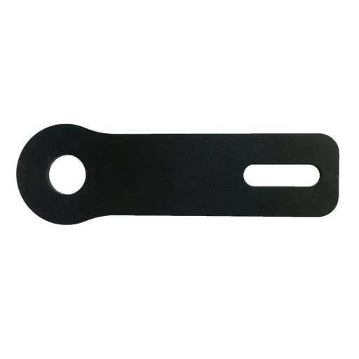

The Rago mount would work fine with a 1/2 wave 2m antenna as it doesn't require a ground plane, however for other antennas that do you would have to remove much of the powder coating from the antenna bracket and the ditch light bracket in multiple places.
You could also go with a fender mount instead of the ditch light or hood lip mount for a better ground.
The generic L brackets are much cheaper.

I'll look at those, too. Do you or anyone have experience with how they hold up to on trail use?
