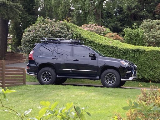

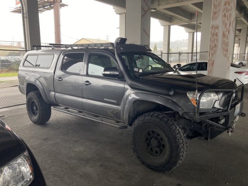

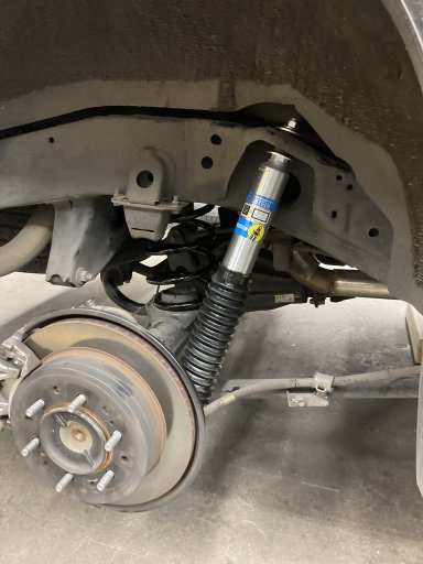

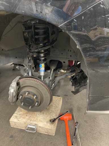

In January of this year I traded in my 2013 Taco on a 2019 GX460. I absolutely love it. I’ve recently started the build and here’s where I am so far. 87EAA1BA-BE21-48F3-89C8-C12E1BF5563D.jpegThis is what I came from.1C9F6C09-7A58-4C15-A012-14402CDE9676.jpegI promised my wife I’d finish my ‘71 Triumph Trident project before I go to crazy with the GX. So far I’ve added 285’s, roof rack, small Bilstein lift, custom built pet barrier and I’m currently building sliders.7784B432-FFC7-447D-A78E-5A9F0B2A1AD2.jpeg3174064A-E5C6-4B43-BE55-7FE009059594.jpeg 5100’s front at 1.75 and rear Bilstein 1” lift spring. I plan on replacing these in the near future after I’ve pretty much got it where I won’t it I’ll run it over the weigh scale again. loaded Vs unloaded is such a compromise in ride quality I will probably look for something that is easily adjustable. I had BP-51’s on my Tacoma for several years and when they were working the ride was fantastic. They weren’t the easiest to adjust whoever.

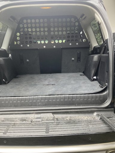

8E7268CD-DADC-4BC7-9CC8-7A9B40AA37D3.jpegPet barrier I built. It’s aluminum and fairly easy to remove when needed. It started to rain on me while I was painting it so the paint job sucks. I will Raptor coat it when I do the sliders I’m working on.

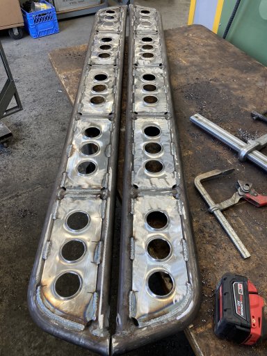

524DF701-3CE8-48A0-8058-43F030A045BB.jpegThe sliders will be bolt on this time as the GX frame has a million threaded inserts from the factory. I’m going to add rock lights to underside they will still come on with door but I’m also going to add a switch for on demand. 8767AE42-0359-4CF4-A648-4416D5376606.jpegMy tent fits perfectly in Ironman roof rack. Winning!!!!!!

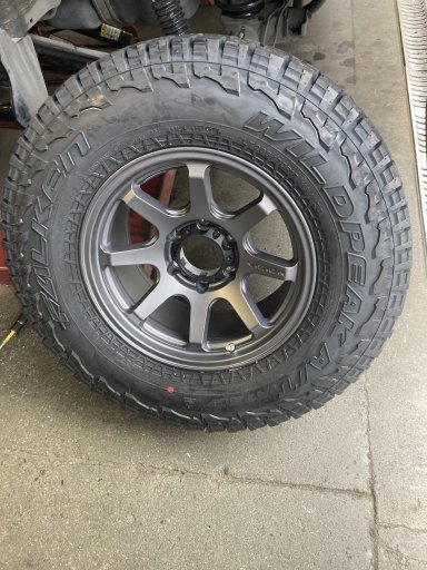

B33C997D-1556-4669-8A27-7D006EFAEE3F.jpegTires are 285/70/17 Falken load range C
Wheels are Vision Flow 17x9 -12

In January of this year I traded in my 2013 Taco on a 2019 GX460. I absolutely love it. I’ve recently started the build and here’s where I am so far. View attachment 241157This is what I came from.View attachment 241158I promised my wife I’d finish my ‘71 Triumph Trident project before I go to crazy with the GX. So far I’ve added 285’s, roof rack, small Bilstein lift, custom built pet barrier and I’m currently building sliders.View attachment 241161View attachment 241162 5100’s front at 1.75 and rear Bilstein 1” lift spring. I plan on replacing these in the near future after I’ve pretty much got it where I won’t it I’ll run it over the weigh scale again. loaded Vs unloaded is such a compromise in ride quality I will probably look for something that is easily adjustable. I had BP-51’s on my Tacoma for several years and when they were working the ride was fantastic. They weren’t the easiest to adjust whoever.
