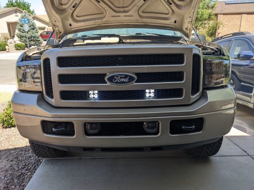

Installed the Auxbeam switch panel. Only thing actually wired is the front camera. Velcro'd next to the column.

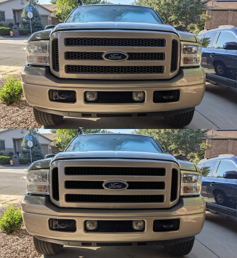

Installed new Harley Davidson-style 05+ headlights and LED projector fog lights. Loving the darker look up front.

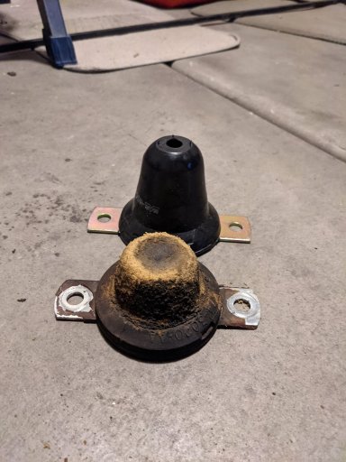

No pics but some maintenance: New bump stops out back, new o2's, new fuel filter. Such an easy truck to work on when you don't need a lift to get at any of that.

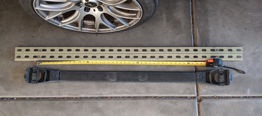

Picked up a Thule box off a buddy, threw most of my recovery stuff and spare clothes and whatnot that doesn't get used often up there.

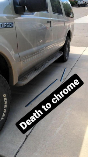

Deleted the chrome rub strips. Can't stand it when OEMs have just a little bit of chrome on an otherwise clean slate.

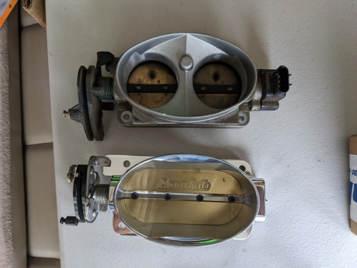

Bolted on the Accufab SCTB96-98 throttle body. What a difference! Pulls hills and on-ramps much stronger and has a lot better tip-in. A whole different truck - like a sport model! A must-buy for any V10 owner IMHO. Takes maybe 15 minutes to put on, just need to add some zip ties at the pedal to take up the slack. Bonus, the factory cover fits for stealth!

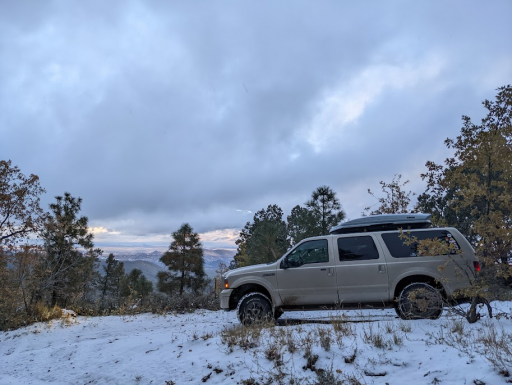

Then the stars aligned and we had a cold snap and a storm hit, so the mountains got a bit of snow.

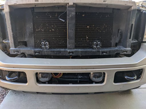

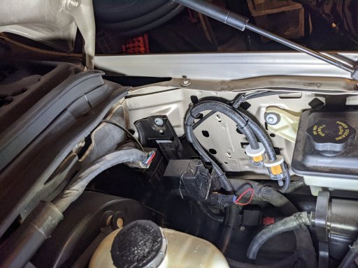

Forgot to post up install pics of the auxbeam 3" pods, which can run amber low or white high beams
PXL_20220529_184122580.jpgPXL_20220530_165712191.jpgPXL_20220530_171543297.jpgPXL_20220530_171601348.jpg

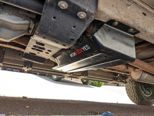

also installed the oem transfer case skidplate, bolted in to factory holes right behind the transmission x-member

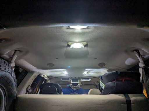

I found a shop on Etsy that prints high-quality LED inserts for the factory interior bulbs, which are almost all festoon from the factory, and therefore don't particularly love bouncing around offroad or put out great light at all. Excellent fit/finish, and they even had instructions on how to solve broken festoon tabs for their setup. the amount of light inside is HUGE, I can see all the stuff my boys throw on the floor now.
