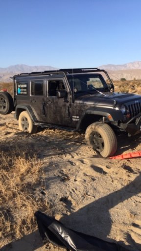

AC5F1044-248C-4C0F-B9AE-6E22B76BD8CF.jpeg Just used my x-Bull traction boards for the first time today. We were out in anza Borrego desert checking out the metal sculptures & bam sunk in the sand. Worked amazing. Told the wife joking around that I wanted to get stuck the night before so we could check out the x-bulls & low & behold it happened. Dug out sand in front of the front & rear tires, placed boards in front & drove right out without having to deflate tires. Just my 2 cents & didn’t have to break the bank as I got 2 sets on sale on eBay for $ 150 ish.
View attachment 75639 Just used my x-Bull traction boards for the first time today. We were out in anza Borrego desert checking out the metal sculptures & bam sunk in the sand. Worked amazing. Told the wife joking around that I wanted to get stuck the night before so we could check out the x-bulls & low & behold it happened. Dug out sand in front of the front & rear tires, placed boards in front & drove right out without having to deflate tires. Just my 2 cents & didn’t have to break the bank as I got 2 sets on sale on eBay for $ 150 ish.
Same experience here, when playing at Sand Lake I've gotten in deep, soft sand. The x-bulls made it so easy to drive out. I need to pick up a second set.
