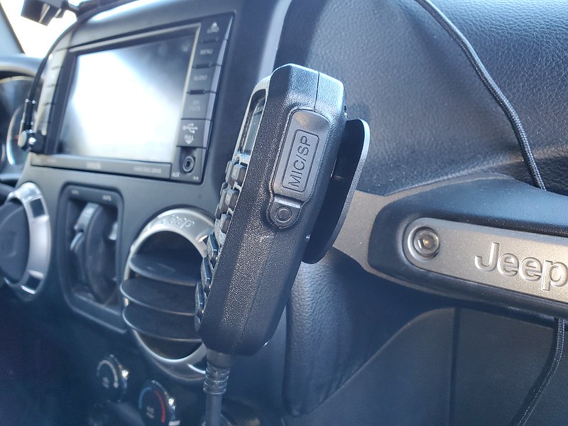

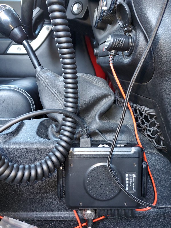

I have the radio bracket screwed to the center console just to the right of the shifter with the mic hanging from a clip mounted on the grab bar.
Just have it temporarily wired to a 12v plug. I still need to route power wires to my switch control box under the hood.

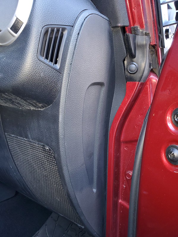

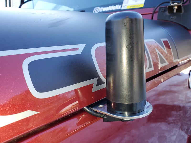

For the antenna, I'm using a 3db gain Ghost mounted on the fender on the drivers side.
I ran the cable across the top of the firewall and pushed it through on the passenger side via small foam hole hidden behind this panel on the side of the dash.

I like that!!! Thank you for sharing. The Ghost mount antenna is super slick too.
You should look into getting the Midland 6dB antenna. I live about 3 miles from work and often have my 275 scanning as I'm driving and can often hear a conversation on simplex pretty much the whole way home.

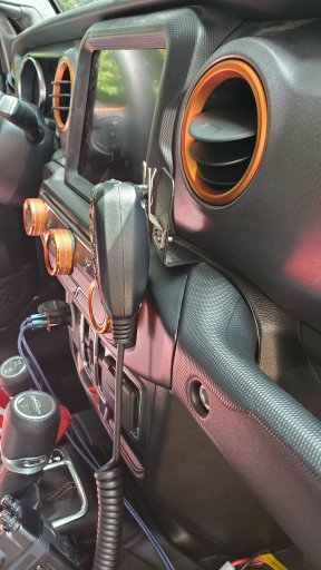

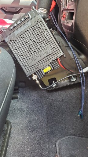

I have a Wouxun (pronounced Ocean) KG-1000G mounted on a Quadratec quick disconnect universal cb radio mount and a Midland Ghost antenna mounted on a cowl bolt using Rugged Ridge MT-ANT-JEEP-DS. Not real happy with the SWR reading on the Ghost antenna though. It's 2.23 and should ideally be 1.0. Antenna is non-adjustable as well. I've order a Laird BB4505CNS to try out. I really like the low profile of the Ghost and it's fine on trails where everyone is close, but I want to reach out to repeaters that may be miles away. Pulled antenna and power thru the Gladiators drivers side firewall plug (not available on manual shift models). For microphone mount I used Areyourshop 75WXST CB Radio Mic Mount Holder Passenger Grab Bar found on Amazon.
I'll get some pics up shortly.
Ran out of good antenna locations on the JKU so ended up with a cowl mount from Rugged Radio, and went thru three different antennas before finding one that had acceptable SWR in that location, the one that came in the box with the midland (Yes I am one of the few that uses Midland aparently..lol) was about useless as was the ghost style. I ended up with a Lard BB4502NS, about 7 or 8" long and managed to get 1.2 SWR, very well build strudy antenna. Have its taller cousin on the WJ and that one is under 1.1, but in the middle of a flat metal roof rather than up against a window frame.
