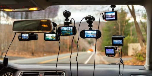

Really, both... I kinda jumped in with both feet and bought a handheld ham radio, a CB radio, and a GMRS radio. I already have a handheld VHF radio that the locals use to communicate in the area we frequent in Baja. I bought them figuring for now I could at least listen in when doing runs, and more importantly, because my wife said Ok. Then, after a while I'll figure out what licenses I want to get based on what I decide is the most useful for the types of trips I'll be doing.
Someone also told me that some ham radios will also work on some CB and VHF channels. Once I've got things figured out, I would prefer to have fewer radios, antennas, cables, Etc. that can do more so I can avoid this:

From my understanding, even though the ham can work on GRMS and CB it’s against the law,

in reality you need all three radios, each serves a different purpose... personally if only wanting on radio, go cb... I have run CB for years, but the further out I start to explore the more I realized that I needed Ham. GRMS hasn’t taken off yet in my area too well, although I know now a few people are making the switch, so I may at one point as well.

Bingo. UHF ham can be made to work on GMRS. Big HF ham radios can be made to work on CB. Neither is legal as radios (except ham radios) have to meet certain requirements and be certified by the FCC to operate on their respective frequencies.
Illegal modifications of radios is neither condoned or discussed on OB.
