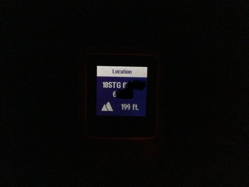

I use an old ipad Mini (wifi only with NO GPS on it), an Inreach mini and the Earthmate app. I connect with no issues, and can se myself along with tracking. Have done it several times in the mountains where there is no cell service.
The pic’s are from a walk I just did in airplane mode, BT’d to the Inreach mini, through the Earthmate app.
I know you all are talking about the Mini 2, and a new Ipad. but the original works great With an older pad.
Not sure if this helps at all

Thanks for the confirmation on the Mini. Basically the Inreach Explorer (what I used to have) and the Mini (1) work.
The Mini 2 does not
It may be because they switched software connectivity to the Explore App from the Earthmate app and along the way they broke the GPS signal pass through.
The question is will they fix it otherwise it's a step backwards.

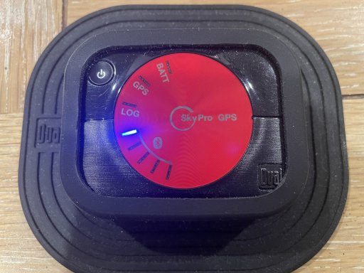

I too use an iPad, since I am a fruit fan - mostly due to photography hobby - and linking with iCloud (iPhone, Mac Mini, iPad). I also use the Garmin Inreach Explorer and Earthmate. I didn't know why OnX or Earthmate didn't work when out of cell range on the iPad and wasn't able to test when I had hoped for it (Vermillion Cliffs/GSE NM).
With OnX and Earthmate I was able to do quite a bit, but as was mentioned above, the battery life when the Inreach was BT paired with the iPad was poor, so I carried a battery pack to charge. It still was wonky every now and then, so changed the ipad location settings to Always as opposed to When Using, since one or both would disconnect when I wasn't actively using. That solved my issues. I didn't know A-GPS was a thing, and I get why Apple would not want to give off device apps the real-time location of the phone, but it would be nice to find in settings somewhere.
Thanks for the info on the Galaxy Tab A8, looked at the snapdragon 410 chipset and see GPS/GLONASS is built into it. Perhaps a purchase is up next. On the negative side, good grief it's like I'll need a pallet of technology just to get a good sized screen nav system!
This is my "Dual" GPS unit. All it does is find satellites. When if finds satellites it hooks up with my ipad with my Gaia Maps and off I go.
Very easy, I'm not a rocket scientist. LOL. It works and works well.

I'm a photographer so I use apple and mac products exclusively. Mine did not have GPS so I just added the $150 Dual unit. I agree I would not buy a ipad just for navigation.
