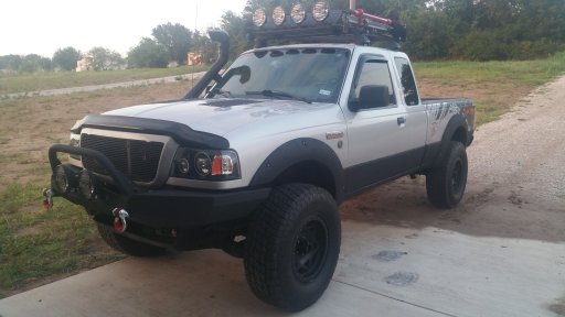

View attachment 30864 Hello all. Just wanted to get some opinions here.
I have an 08 Ranger FX4, upgraded to HD torion bars a few years ago. Added a steel bumper only 90lbs, caused no sag. But...I'm planning on adding a winch to the bumper now, which will add about 60lb -78lbs. If I encounter sag, would upgrading shock, Rancho 9000xl, help sag?
Thanks for the input and help! Happy and safe wheeling to ya:smiley:

If someone makes a adjustable coilover I would go with that vs a new strut.... I believe Fabtech makes a upper control arm and a lift coil for your truck....
I agree with Raul. A strut won't do much in terms of ride height. That's determined by your torsion bars.
Other than cranking those down to increase the height, your only other option would be to upgrade to coilovers which can be a little costly.

Thanks man. Ya I'm in touch with a guy who makes a coilover conversion kit for Rangers. I'll probably be doing that within a few months. Other than that I'm happy with it. Had a lot done to it, for the trails I wheel, it's perfect.

I don't want to say don't trust the guy, but do some research and make sure he knows what he's doing. Suspension is tricky and takes a fair amount of mathematical knowledge to properly build. The big name companies like TC, Fabtech, Camburg, etc.. all use jigs to ensure proper fitment and angles. The last thing you want is to have your $100 brackets misaligned and blow out your $1000 coilovers.
You'll also definitely need new uniball upper control arms to correct for the new angles.
