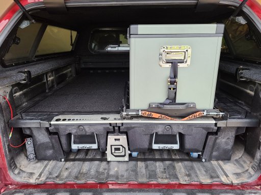

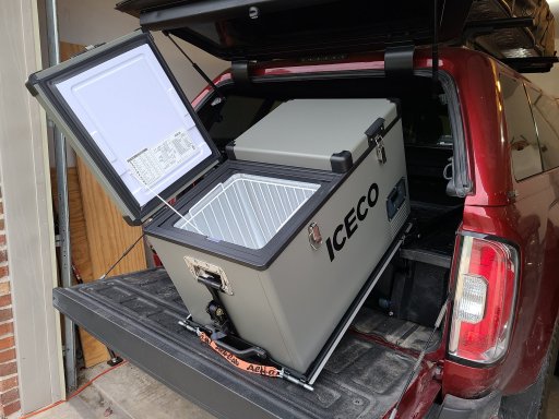

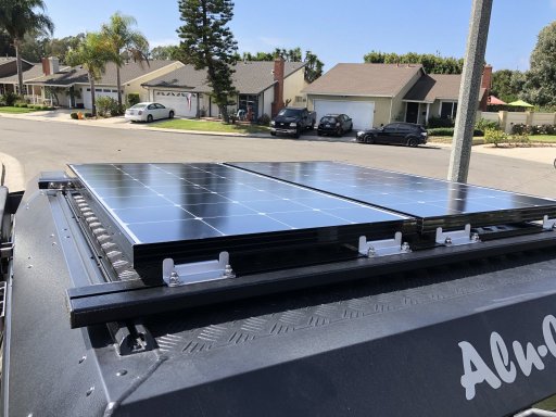

Got a Dometic CFX75 and a Alu-Cab fridge slide from OK4wd. OK4wd gives you 50% off the fridge slide when you combine the two. I mounted the fridge slide on Decked Yakima rails. I lined up the holes to the dimples on the decked platform and then cut the rails to match length of slide. Got Yakima square nuts off of Amazon and started piecing together. Worked perfectly and is rock solid. Figured I would post to give others some ideas. The fridge plugs into a 100wAh's Renogy lithium iron phosphate battery that I have connected to two 100 watt solar panels mounted on my Alu-Cab gen 3 rooftop tent. Battery and MPPT controller are housed in a Leitner storage cube with two 12v marine outlets on back of box. Here are some pictures.View attachment 126727View attachment 126729View attachment 126730View attachment 126731View attachment 126732View attachment 126733View attachment 126734View attachment 126735View attachment 126736
When fridge is not in truck I can use the slide for my parts and tool boxes for easy access.

Hope this helps. I have had this setup in the rain with no issues. I have a cover on my dometic and put filter material over vents and the refrigerator has run fine. I put inline fuses to the 12v outlets and have not had any issues. The Renogy controller has bluetooth which I mounted to inside lid. You can control it via phone or iPad.

OP: the screws you have on the T tracks going through the metal ruler endplate of the Decked, are there steel support bars in that spot and is that a risk for causing a leak at that spot?

Is that the Dometic slide? or another mfg? Great set up, I like the tilt feature, my fridge is just too high with the lift and the decked system installed.

If you want to be able to easily remove the entire Alu-Cab slide then using tracks is a great idea. If you don't care about that then there's no need to mount the Alu-Cab slide to anything other than the Decked cover, which is exactly what I did when I had my ICECO VL60D in my truck.

Thanks! I was thinking about mounting on top of Decked Yakima slides, but they’ve been “sold out” for awhile.
Got mine from Amazon. The reason I went the Yakima rails also is it allows to position front to rear and also to keep the decked system water tight. The holes on the rails align perfectly with the dimples on the Decked system.
