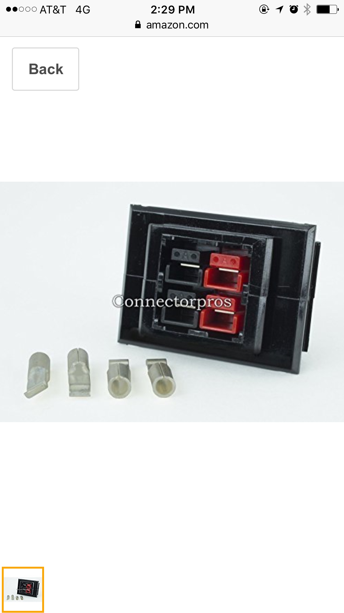

Amazon
https://www.amazon.com/gp/aw/d/B014UC9QNU/ref=ox_sc_act_image_2?smid=A1I38293STBMIC&psc=1

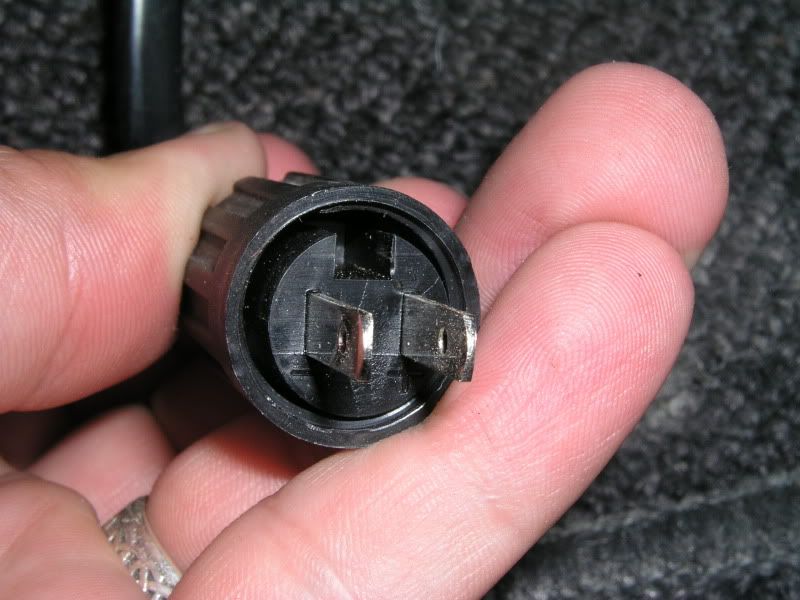

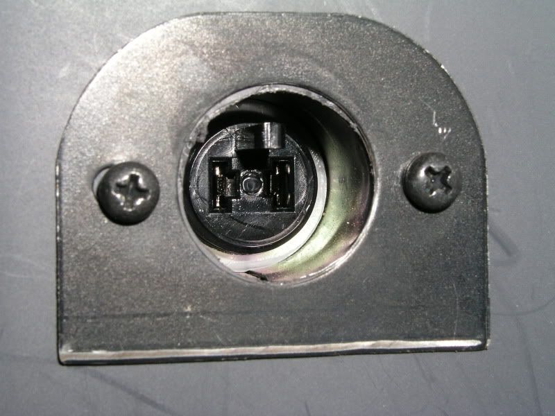

I have just come across another solution, which will allow you to retain the functionality of a rear-mounted 12 Volt accessory port whilst upgrading to a more secure screw-in type connection for certain uses.
ARB have developed a Fridge Freezer DC power cord and power plug solution for the more adventurous 4WD owner who wants to minimize the voltage drop in the electrical connection and have a secure plug when traversing corrugated roads. The 12v plug tip can be removed and the special two pin plug can be screwed into the matching ARB power socket for a secure connection. The 12v plug end includes a replaceable fuse, while the threaded section has a locating pin to ensure correct polarity.
The operation of this new style of 12v power connector is probably best illustrated by watching the following short video:
