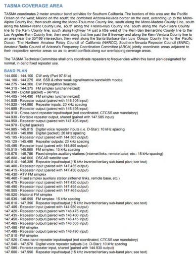

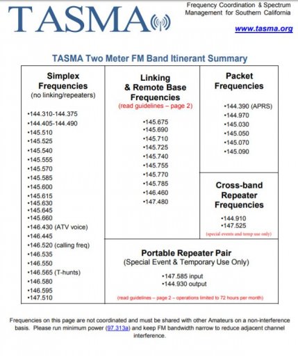

Brien remind me if im wrong but they told us as long as we used simplex and no tone it would not interfere. They require CTCSS or DCS for linking.
From TASMA
FIXED AUXILIARY STATION FREQUENCIES
The following 10 simplex frequencies are available for auxiliary station operations such as internet linking & simplex auto-patch. Cross-band repeaters are not permitted in these frequencies per FCC Part 97. Use of selective access such as CTCSS or DCS is mandatory. All frequencies should be used on an intermittent basis with no continuous internet linking. Stations should follow guidelines for proper operation detailed on page 2.

Yes, we can still use 146.46, with some caveats, here's my take:
First, here's the full band plan doc, including the second page that was omitted from the attachments in the post above: http://www.tasma.org/TASMA-2m-Band-Plan.pdf
I would think that as long as you are not using a CTCSS/DCS tone you would not interfere with remote control of the auxiliary station, but if you observe one in use, you should change to a different frequency. As per our OB guidelines, any local coordinated band plans should take preference, but that doesn't mean that one couldn't use 146.46. In this case, the coordinated use takes priority use of the frequency. Meaning, in this case, if one is using 146.46 for simplex calling, but that use is interfering with the coordinated auxiliary station (it's coordinated, because it's frequency is defined in the TASMA band plan), then the simplex stations should move to a different frequency. In the rest of the doc, there are more details about these aux stations: they must be low height, low power, and they must use selective access. The band plan doesn't say "Don't use this frequency for anything else" it just says 1) if you are going to set up an auxiliary station, use one of these 10 frequencies. 2) If you are an auxiliary station, and you are using one of these frequencies, you have priority over othe ruse"
TLDR; Band plans designate PRIORITY of use, they don't "lock down" frequencies. This means that It is fine to use 146.46, but if you are told that your use is interfering with somebody's coordinated auxiliary station, then move to a new frequency. if an auxiliary station's use is designated and coordinated in the band plan, it should always take priority over "normal" simplex use.
I hope that clears things up.
