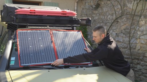

I recently wired everything in order to use my portable / foldable 100W solar panel to keep my AUX battery charged when I spend multiple days at the same campspot.
I think this is cheap, easy DIY, and convenient system. Especially when you don't have a lot of space to put a permanent solar panel on your rig.
I've made a video about it, so I'll let you watch for more details.
Hopefully you will got some ideas or inspiration for your own setup !
This is the Dokio 100W Solar panel I use. You can find it on Amazon or Aliexpress for around 100€/$
On my last test, it gave me 4.5A and putted the battery at 14.2V.
My smart battery system even linked my two batteries to charge my MAIN and my AUX battery at the same time !
⬇This is what my electrical panel look like. You can see the power outlet with the SAE connector/cable of the solar panel.⬇
It's the only cable I have to plug to use my solar panel ! It's pretty simple and quick to setup at camp.
I hope you enjoyed it !
