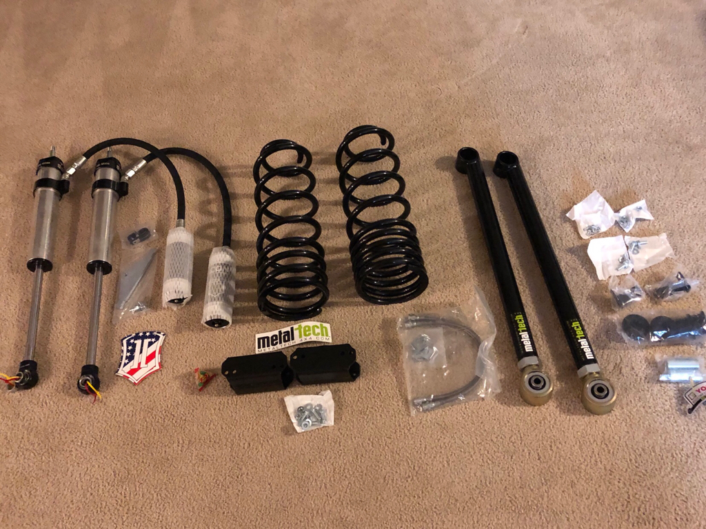

Rear suspension is rebuilt and my rig is sitting on all fours. Installed a Metal Tech long travel kit with heavy springs and Icon 2.5 remote resi.

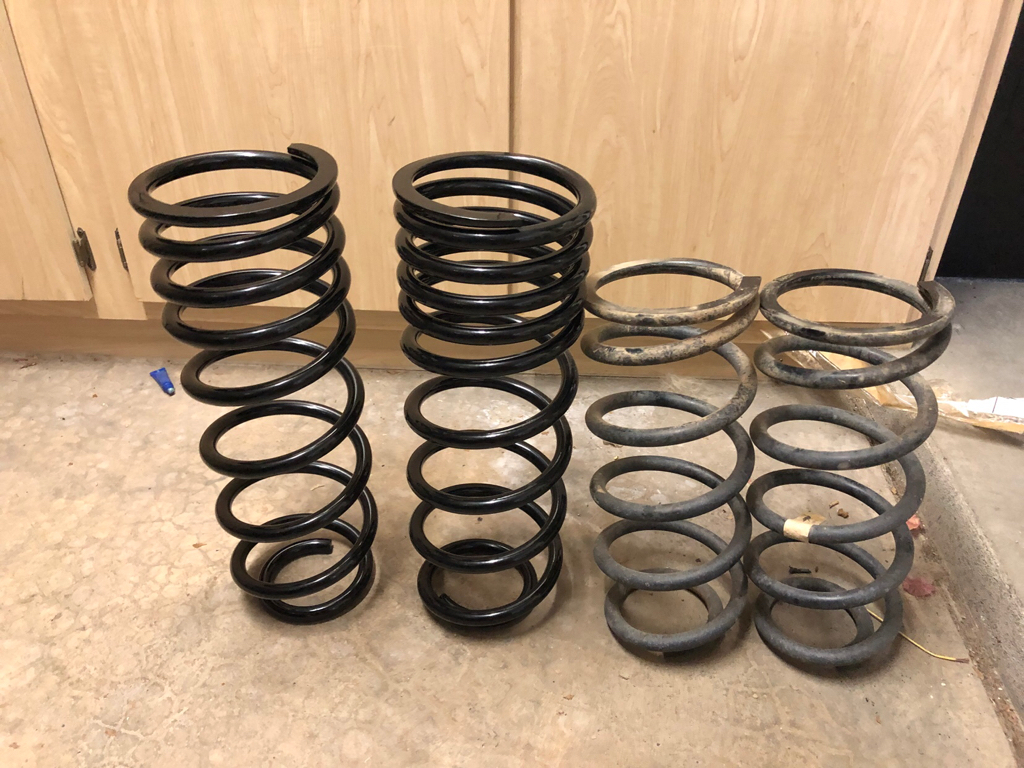

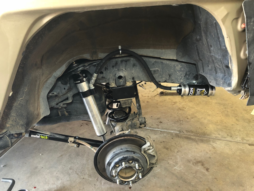

The springs are a bit taller than the OMEs making them fun to install without a spring compressor. Ended up completely disconnecting the lower link allowing the axle to droop a little further.

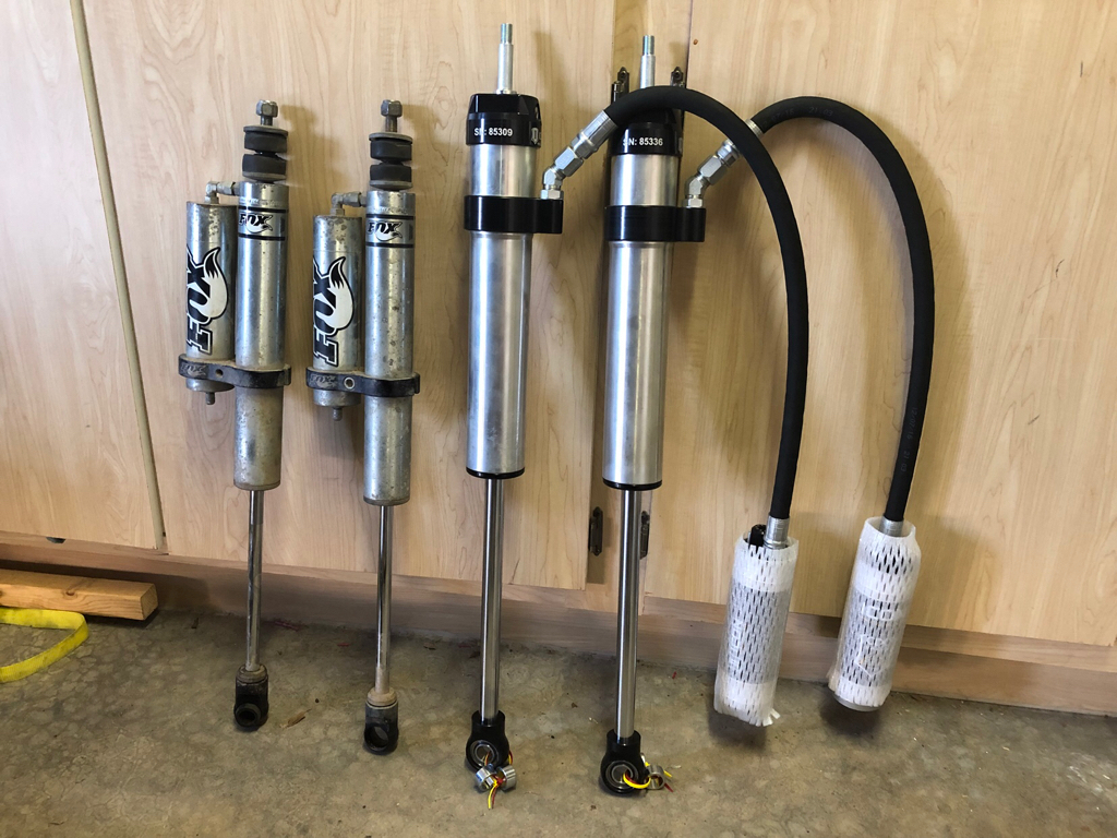

The Icon 2.5 look gigantic next to the Fox 2.0
Install complete!!!
First test drive was promising. FJ seemed to track straight and it made short work of the speed humps in my neighborhood. I’m looking forward to getting her off-road again soon.

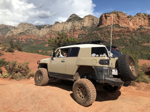

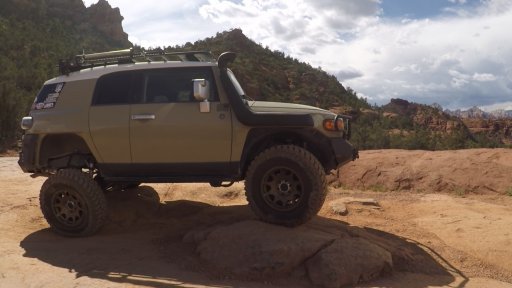

Finally took the rig out to test the new Metal Tech long travel suspension. The Metal Tech heavy springs w/Icon 2.5 shocks were a huge improvement over the OME w/Fox 2.0 shocks. The ride was smooth and we never found the bump stops. It should be noted that I carry a lot of extra weight which motivated us to try a stiffer set up. Our test run was in Sedona AZ on the Broken Arrow trail. My wife did all the driving while I had fun spotting and getting some snapshots!
If you have never run the Broken Arrow trail and you find yourself in Arizona, I highly suggest you check it out. The trail is mildly challenging and the views are spectacular. I plan to do a write up on the trail in the future.
