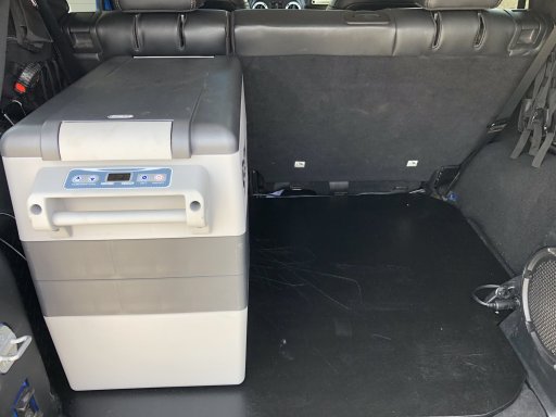

Finally joined the fridge/freezer club! Costway 54qt

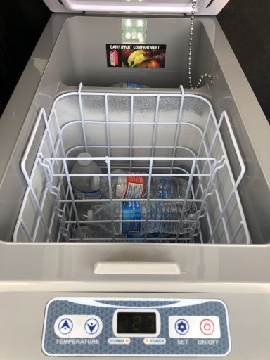

Anyone noticed the inside temp is not the same on the screen??,i always need to play with it,if i need 4°C i have to put 5 or 6°C.
Reactions: PolarExpress
ErnieC
Good to know [emoji109]
yes, I'm wondering where their temperature sensor is since I have 3 thermometers inside and none of them are in agreement with what the display setting shows.
I have a wired temperature probe in the middle of the refrigerated compartment along with a wireless one to double check that hardwire sensor as well as an old fashioned thermometer in the non-refrigerated compartment just to see how much warmer it is at various settings.
My standard testing temperature with the display set to 36F shows that the refrigerated compartment is usually around 32.5F.
Taking out a bottle of water from the refrigerated section and measuring the water with a digital thermometer shows that it's just slightly above 32F

Actually it does. I just got one to play with from Amazon and have been tinkering with it for about a week.
If you push and hold the Settings button for 5-6 seconds it will blink and take you to the extended settings.
Push the settings button 2 more times so that E3 is displayed and then hit the up or down temperature buttons to adjust the setting. I think mine was shipped with the E3 register set to 3. (long story on why/how I found all this out) I believe the E3 register tells the brains when to turn the compressor on.
I had to perform a factory reset and see that the new default setting for E3 is now 1. The cooling behavior of the fridge changed from the way it was shipped to me when I ordered it from Amazon. It used to turn on at TargetTemperature+3 degrees. Now it turns on the compressor when it's 1 degree past the TargetTemperature.
The end result is that it runs more frequently but the temperature doesn't fluctuate as much for the cooler.
e.g. as shipped and initially tested the compressor would turn on at TargetTemperature+3 and then turn off at the TargetTemperature, but then the display would drift down to about TargetTemperature-4 and then slowly climb back up until the next activation cycle.
So in the original config it would run the compressor for about 5-6 minutes and then not activate again until 25 minutes later.
In the new setting, it would run the compressor for about 30secs-1.5 minutes and then not activate again until about 6 minutes later, but the temp would always be at TargetTemperature +/- only 1 degree.
