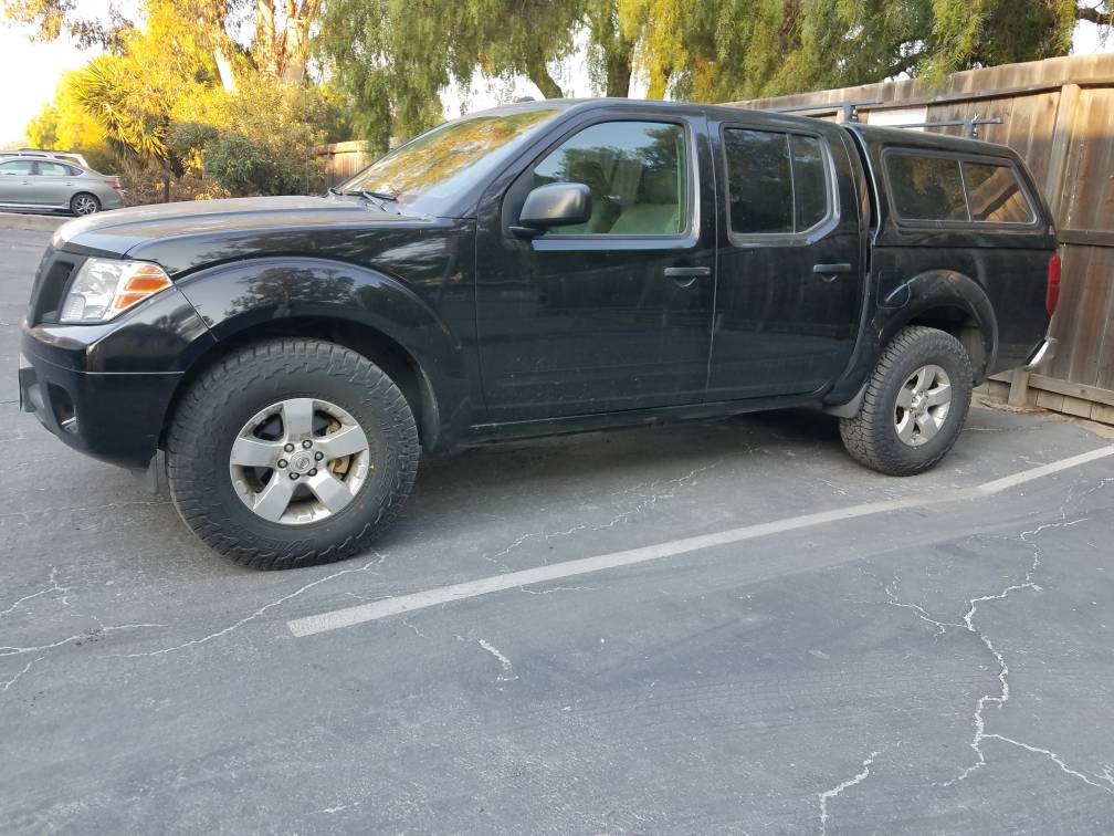

So I finally got around to replacing the tires on my rig, it's is my daily driver so I looked for tires that had good wear life but also have an aggressive tread pattern. After looking at quite a few tires I ended up going with the Falken Wildpeak AT3W's they have a 55k mile warranty and aggressive tread.
So far I have put about 600miles on them all on the highway, they are pretty quite on the road just a slight humm at freeway speeds, nothing that I can't live with. I will continue to update this review as I put more miles and put them through some trails!
