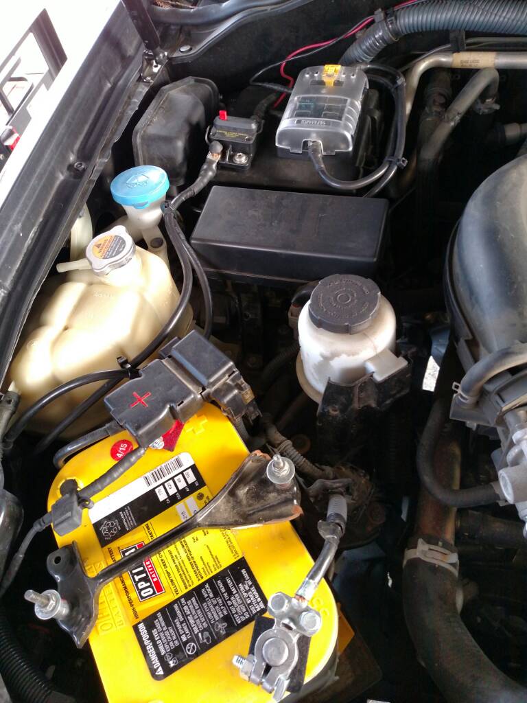

I fitted a yellow top Optima about 4 months ago, my OEM battery had started spraying at the caps and generally making a mess
Here it is, I fitted the Blue Sea fuse box and circuit breaker at the same time.

I also started venting my battery and it was only 10 months old. I said screw it and put in a odyssey 34R (reversed terminals) required to keep pos and neg where they are in the X and as Maktrak's photo also shows, the Xterra has a retarded fuse block/ bus bar that we need to keep or completely rewire. So the 34R was great for my usage. I will be getting a second and running dual batteries hopefully by the end of the year.

That positive battery terminal is absolutely ridiculous. I looked into relocating the thing and it's so convoluted and runs so many amps thru it it wasn't worth my time.
I have a spare OEM terminal in my toolbox. If it ever smokes on you you'll wish you had one too. Ask me how I know!
