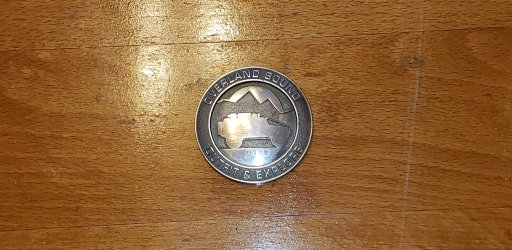

Hey folks! I've had my badge on the back of my 4Runner for about 3 years now and the mag sulfate has totally torn it up. Instead of purchasing a new emblem, I attempted a science experiment which is basically the "magically make a penny shiny" experiment. IT WORKED!
Get a small bowl or cup that will fit your badge inside, add white vinegar and salt- let it sit and voila! Good as new.
BEFORE:
AFTER:
After it sat in the solution for about 1 hour, I took it out and wiped it off with a paper towel. Pretty neat!

The "before" picture doesn't show up :-( I am curious how the transformation was.

Well, inquisitive minds want to know what this witches brew is that made your emblem almost new again.

Cool, worked good.
Salt and vinegar is used a lot in the restoration of coins. It can also work on other metal things to remove oxidation/corrosion. It is amazing what simple household supplies can do. Simple things you have on you shelf or under the sink have way more uses than you think.
