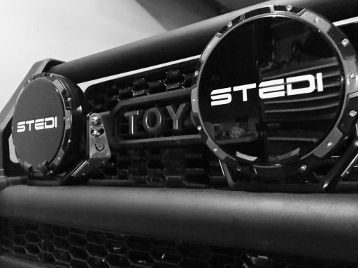

Anybody else using the Stedi Type X Pros for lighting?

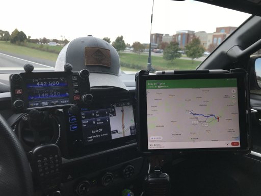

Is that a Surface tablet mounted with a Hondo Garage Un-holey vent mount? I have a Surface - thing is really heavy. Is it ok there?

Yes that is an iPad Pro 10.5”. I have ran it like that for a couple years on and off-road. The mount does well. At the time Expedition Essentials didn’t exist. I think for the most part the Hondo Garage is great. I would probably like to get my vents back though. So EE is probably in my future.

Where is your base unit for the FTM-400 mounted? I thought about putting my display where you did but I am right handed and didn't want to have to reach over that way. I'll post a picture of mine when I get home.

The base unit is under the driver’s seat.
I have played around with my head unit. It is now towards the good times radio.
I also have a Midland MXT400 on the passenger side. View attachment 112964View attachment 112965View attachment 112966

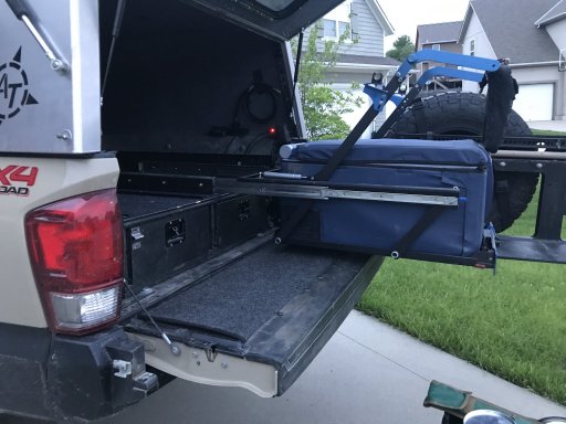

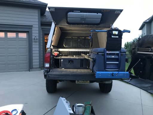

Some people tend to ask about my fridge slide. It is a MSA Drop Slide. I had obtained it several years ago directly from MSA in Australia.
There was another company at the time in the US who was making a knock off of their original product. It was cheaper to purchase in Australia and have it shipped than buy the US version. So that’s what I did.
The slide makes it very easy to load and access food and drink from the fridge. View attachment 112986View attachment 112987View attachment 112989

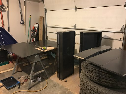

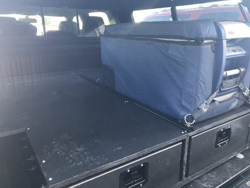

Since I posted about the fridge slide I should talk about the drawer system.
I wanted a drawer system to store my tools. repair gear, and kitchen items.
The most cost effective way was to build my own.
I knew I wanted to put a house battery in the back of the truck.
To protect it and keep it out of the way I put it towards the cab.
Dead space was left between the back of the drawers and the area near the cab.
The drawers and cabinets are built with plywood which was treated with a textured paint.
The drawers have half inch bars on each side that slide on roller bearings.
The top of the drawer cabinet has outdoor carpet covering the top.
View attachment 113059View attachment 113060View attachment 113061View attachment 113062View attachment 113063View attachment 113064View attachment 113065

@Paris0514 I think the Ipad is a fair bit lighter than my Surface tablet. I would like to have a place to mount it but would probably need to come from the floor. My FTM-400 head unit is temporarily in a cell phone mount, which works surprisingly well. I am going to move the head unit next to the tablet. I have a piece of metal with threaded mounts to fit ram mounts right above the radio bezel. (I realize it looks like it blocks my view but it is adjusted so the top of the tablet is even with my view of the horizon of the front hood.) The base is in between the rear seats. Mine is an access cab and I have a platform for my dogs. No provision for human seating in the back. :grin:

Looks great! I have my 400 head unit on a ram phone holder on the Honda garage mount. Works really well.
If you are looking for another option on mounting the tablet you might consider what I might be doing in the future and using this instead.
This will allow you to have a heavier object mounted without concern of falling off, damaging anything, or unnecessary movement.

That is a nice looking mount and sturdy too.

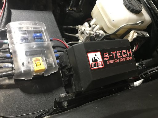

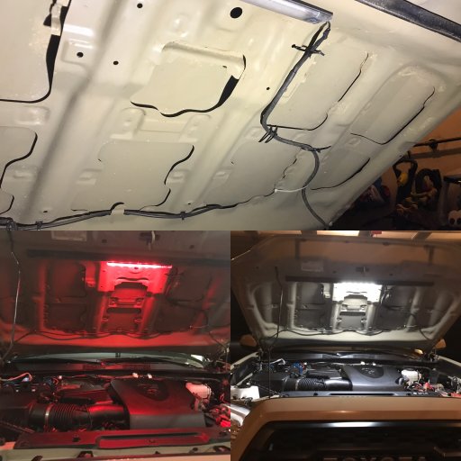

Here is more pictures of the lighting I have currently on the truck.
A write was done for the Stedi lights in gear review found here:
View attachment 113133View attachment 113134View attachment 113135View attachment 113136View attachment 113137View attachment 113138View attachment 113139View attachment 113140
