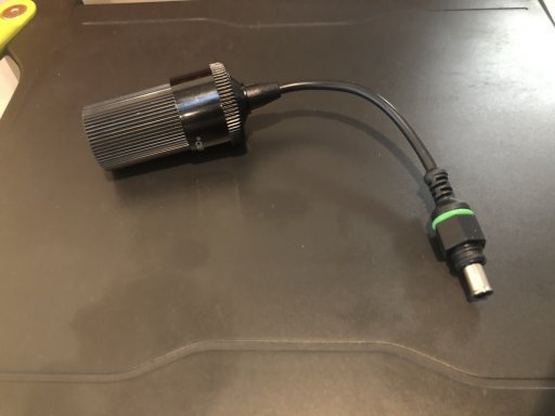

BTW, GoalZero do support running fridge like ARB, Dometic. The 12V output cigarette socket output on the yeti has a problem supplying constant 12V. You will need use an adapter - 6mm to female 12V cigarette socket and connect your fridge through the 6mm output ($5 adapter).

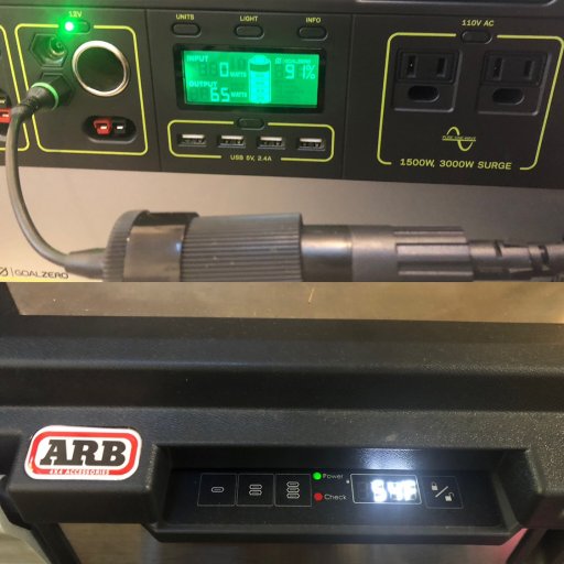

Tested the GoalZero this morning connecting my ARB fridge to Yeti 1000. It works. There is a gotcha. I need to set the fridge voltage monitoring to low instead of high. Here is the picture of the setup and the adapter needed.

  • Set your fridge to the low power setting.
  • Call GZ and ask for the 12V adapter plug (as seen above) They sent mine out at no charge...You'll need this with an ARB fridge because the 12v plug is a bit to shallow to make full contact with the contacts of the GZ. (I cannot speak for other fridges and plugs)
