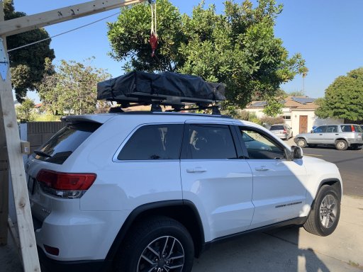

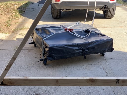

So after a lot of online searching, I couldn't find a compact solution to hoisting my RTT on to my truck. My garage is too low so I can't lower it off the ceiling and drive away unfortunately. After a lot of brainstorming and about 3 trips to Lowes, below is my working hoist. I tested it with my weight (185lbs) first to be sure it would hold, and it didn't budge at all. My tent weighs about 135lbs so this solution works great.
I have 3 pulleys on it so the pull weight is down to 1/3 of the weight of the tent. It breaks down into two main pieces, the hoist arm, and the a-frame. The a-frame folds up so both pieces fit nicely in a small corner in the garage. If anyone is interested in further details let me know.

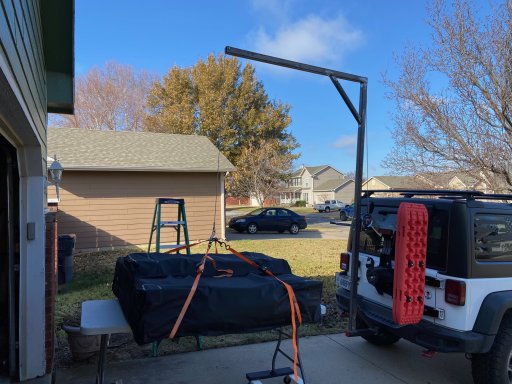

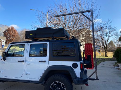

Hey everyone. I was searching the web to find a solution for installing my rooftop tent by myself, and I came across this thread of ideas. I liked some of the ideas on here, but they weren't quite exactly what I was looking for - so I made my own version!
Like many of you, my garage roof is tall enough for the tent to be installed on the Jeep on the inside, but the garage door is too low to be able to drive in or out of the garage with it on top. The garage door opening is only about 7' tall, and I need at least 8' to clear. So I needed a way to install it on my driveway.
I decided to use the receiver hitch and make my hoist attach to the Jeep. I basically used 2" square tubing with 1/8" walls, a couple of pulleys, and a hand crank winch to accomplish this. I used a 1 3/4" OD round tube inserted in the vertical part of the lower receiver portion to allow the crane to pivot around. The crane comes apart so it's easy to install/remove/store.
To test it initially, I hung off the end of the crane and it held me just fine (I weigh 220 lbs), so I knew it would hold my 116 lb tent.
I have about $100 in this project, and it works great! Yes, I realize knowing how to weld helps, but this could also be made by bolting it all together with some modifications. If you have any questions, I would be more than glad to answer them.

Thanks for your response!
The hoist doesn't use the garage door/frame at all. It simply plugs into the receiver hitch on the Jeep. I made the hoist frame in two parts so I can install it by myself since it's kind of awkward fully assembled. Just for SA. I spent about $60 on the metal, $25 on the hand winch, and $10 on the pulleys.

Do you need to remove the rear spare to place it in?
Probably not - but I made the receiver portion of the hoist as short as I could to minimize the load on it. I think it would be ok if you made it long enough to clear the spare - I just chose not to.

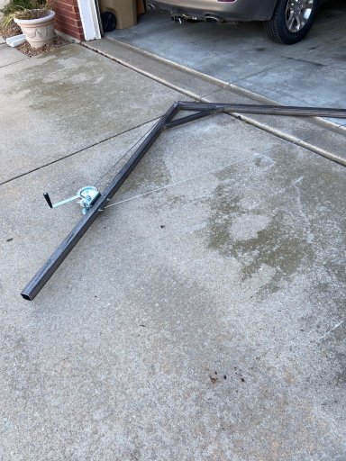

I need to see more to understand how it works. I don't see anything that can plug into a hitch on the three pics you supplied.
That's weird - I posted 8 pictures. You only see 3? Ok - so here is a picture that shows the receiver portion of the hoist.
Yes, for some reason there is an x on 4 or 5 pictures on my end. I see the receiver pic fine.

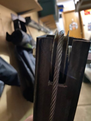

Great idea, nice simple concept, do you have a close up photo of the pully arrangement?
Here are some close up pictures of the pulleys. I slotted the end of the square tube on one side, and used a bolt with washers to help center it. The pulleys are 2" in diameter.
