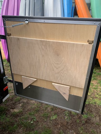

Looking good. You might need longer door chains. It doesn't look like you'll have access to your fridge with the table down.
i can disconnect the chain, once I build my fenders and protection around the bottom of the trailer I’m going to put a lock system together to hold it open straight out to the side

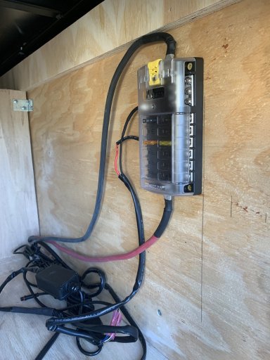

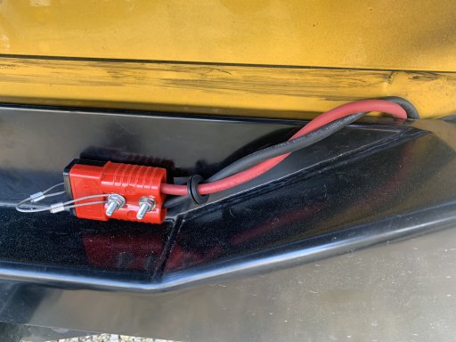

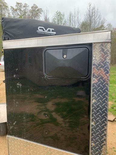

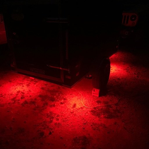

Wow didn’t realize till just now it been so long since I showed an update!!
Pic 1)I’ve installed Rock Lights
Pic 2) fuse block for pump, and lighting
Pic 3) 4 Ga wire installed to charge trailer batteries from Genesis Dual Battery Kit
Pic 4) KC lights installed on rear of trailer
Pic 5) Anderson Plug on Jeep for wire on trailer to charge batteries.

1) Rock Lights at Night

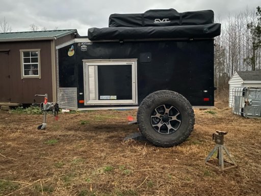

Overland Vehicle Systems 270 awning installed
First Picture is last weekend, getting ready to drop the 2000lb axle, and install a 3500lb brake axle. This picture is what the trailer will look like afterwards.
Just waiting on axle to arrive.
