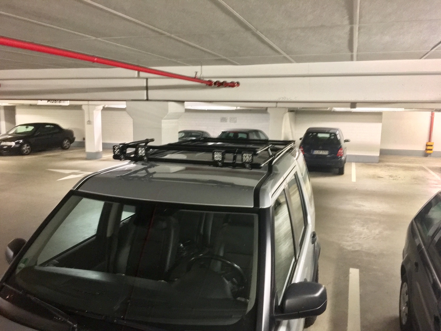

addition for guys in europe, this is the shop were I ordered all the stuff for the diy roof rack on my niva (40mm):
http://www.brinck-rohrverbinder.de/shop/Rohrverbinder:::1.html?language=de
don't wonder about the mm to inch connections in the listing on the left. makes no sense. focus on the mm measures. unfortunately no 25,4, multiplies or submultiplies available.
good thing: you can order stuff in powder coated paint in your desired color (ral code). for the fittings just select anodized to get the about right price.
quality of that stuff is top notch. it's the same stuff that public transport companies over here use in their busses and trams.

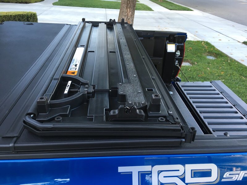

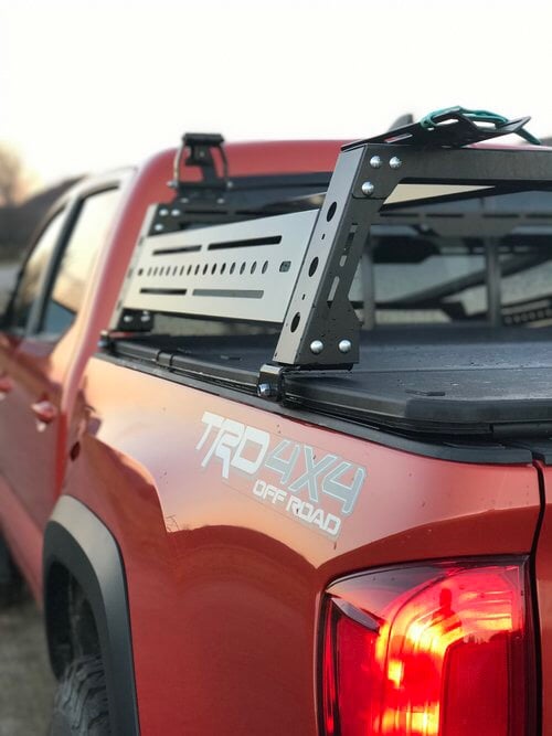

Sprocket 1-505
Atlanta
21933
Great post man. I have been wanting to build a bed rack for my Tacoma. I've made a few things from flat bar but need a little guidance with something on this scale. Do you have any drawings or plans? I still want to keep my factory bed cover and still utilize the bed rails. I've seen fab brackets by voodoo I might be able to buy for 100. But the rack itself is the challenging part. I think a mid hight would work for me. What are your thoughts? Would like to use as a platform for and regularly tent till I can splurge on an rtt. I'd also like to mount fuel cans and spare. I can work how and location out later, just curios about weight. Voodoo has a good rack at 550+100 for brackets. Is it worth the DIY or fork over for the voodoo rack. Thanks in advance.
Devin
Some images if your not familiar with the set up and with voodoo

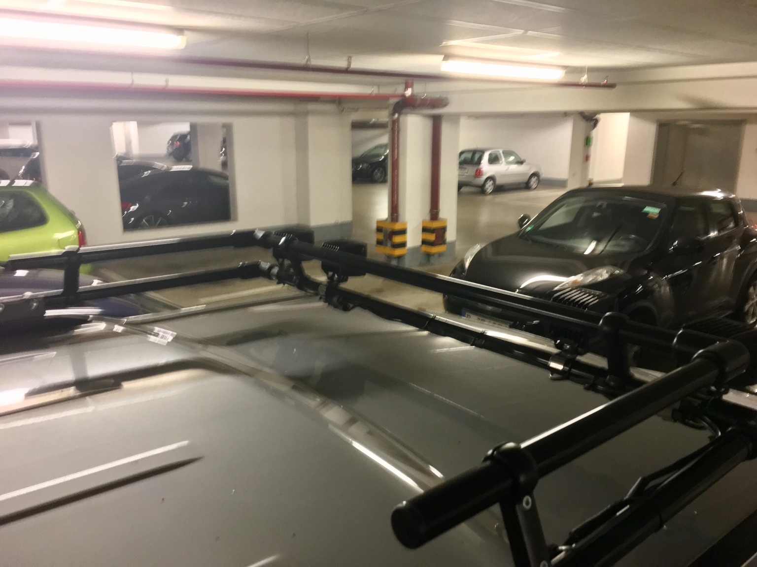

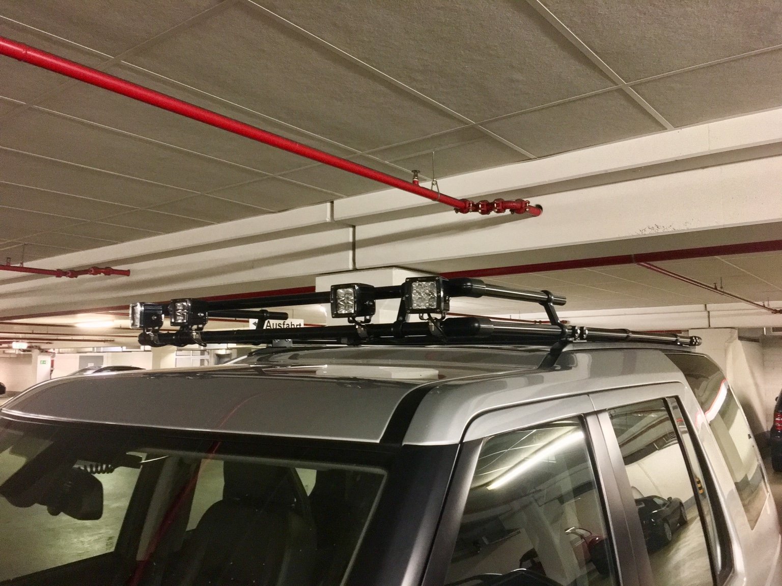

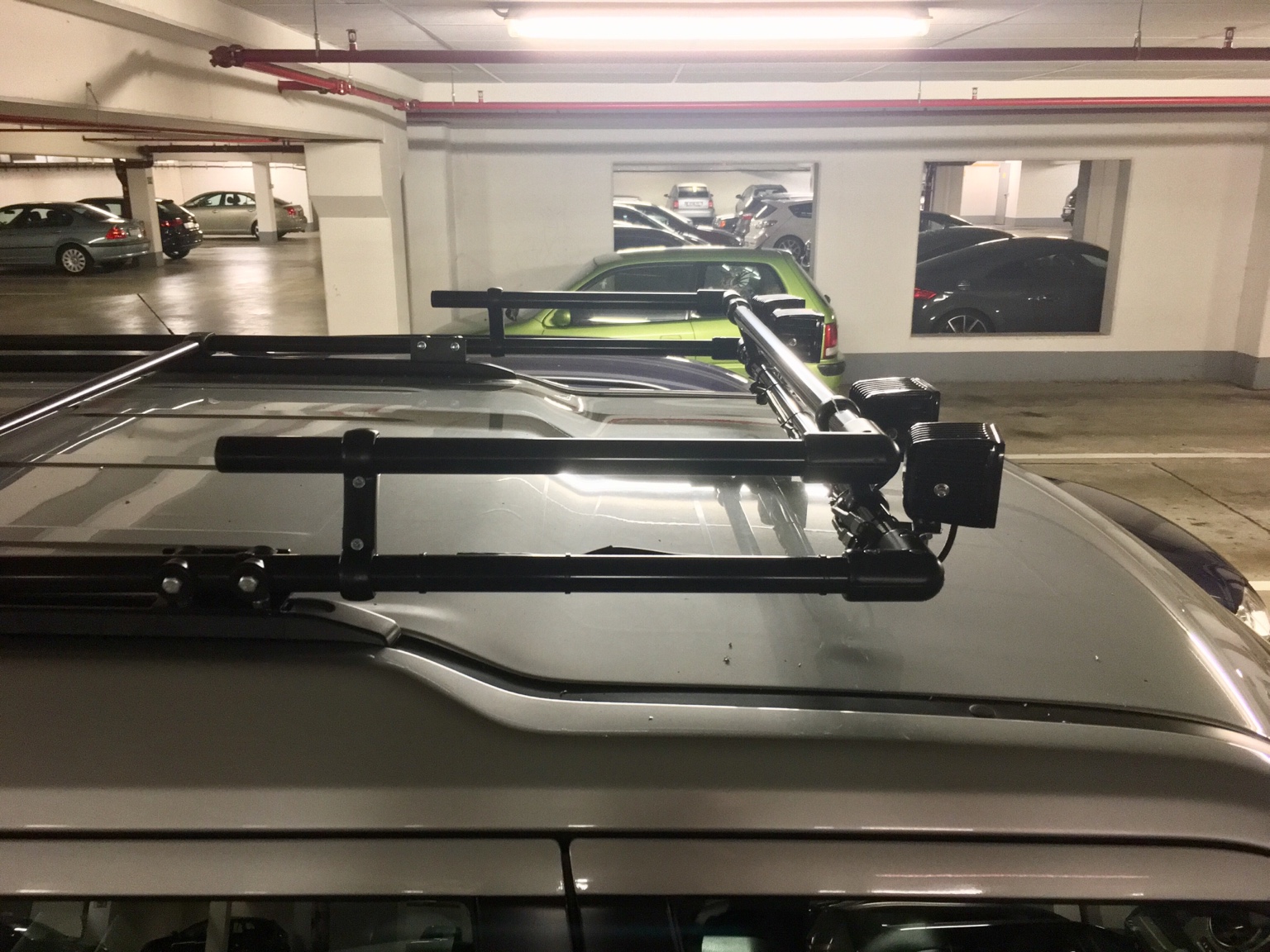

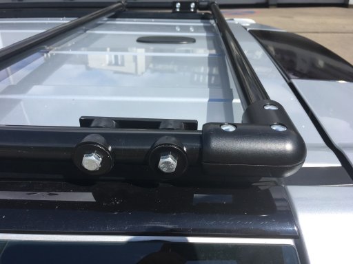

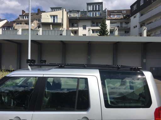

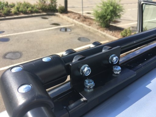

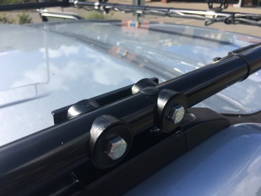

first stage ready. upcoming next week(end): top rails around the front, and awning mounts.
most of the rear part will be kept free to host an ARB Simpson III opening to the side.
UNADJUSTEDNONRAW_thumb_6ad5.jpg UNADJUSTEDNONRAW_thumb_6ad6.jpg UNADJUSTEDNONRAW_thumb_6ad7.jpg UNADJUSTEDNONRAW_thumb_6ad4.jpg
edit: to add a bit of information about the why. 2 arguments:
1. why buy a commercial full roof rack to have about 75% of it unusable cause it's covered by the RTT?
2. weight. let's take the full size frontrunner. 70lbs. RTT is 110lbs. max roof load is 150lbs. end of the story. this minimalist rack weighs just some 15lbs.
