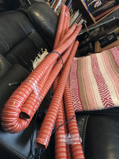

Testing the heater with the silicone flex ducting was a success. The heater came with two short aluminum duct pieces about a foot long each. I used one of these pieces to close off two of the four vent stubs on the face plate. I connected one 3 foot section of silicone duct to one open vent and a 12 foot section to the remaining vent. I connected the unit to one of my truck batteries via jumper cables and powered on the unit with the remote fob. I set the output to level 6, the highest setting. It took just a couple minutes to prime and startproducing heat from the open vent-ducts.
at 12 ft away from the heater, the laser thermometer read an average of about 110 F. The short 3 ft duct read about 130 F. The ducting near the vents averaged 140 F, and was too warm to touch with my bare hand for more than a few seconds. The ducting near the open ends of the two lengths could be easily held but were quite warm to the hand.
