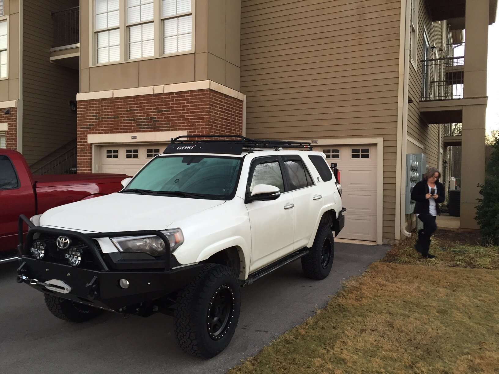

Thanks. I'll pick some up. The wife and I are building up her 4Runner. Decided to sell the house and our stuff. Take a year off and tour US, Canada, Alaska. Hope to be ready within the next 4-6 Months. We have been 4wheeling and camping in the FJ, but your site and XOverland has gotten us both excited. She had breast cancel 5 years ago, I got really busy in Business, its time to do what we want, stuff be damned. Our kids are grown, have grandkids but we want to travel before we are too old. I was planning on showing the build on the forum. Planning on visiting some of the areas you highlight in California. Going to hit all of the National Parks. Think it going to be awesome. Also finishing up an off road trailer. We are going to the Expo in Asheville in a few weeks. Getting some ideas for the rig. Take care and keep it up. Ralph
