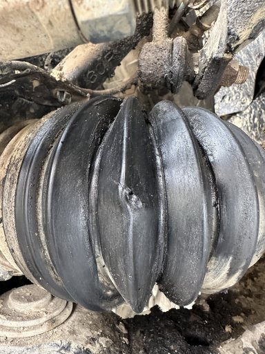

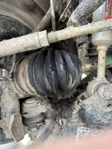

I just returned safely from a highly anticipated overland trip from Michigan to the Canaan Valley area of West Virginia. We drove out early Thursday morning but had to cut the trip short due to vehicle issues.
Thursday night when we arrived we had a house rented so that way we weren't pressed for time to find a suitable camp spot. We had enough time to explore and hit the trails. We decided to hit the trail that I was most looking forward to in the area the Canaan Loop. The trail was amazing and everything I could have asked for. It was a whole different experience than the lower peninsula of Michigan. The Tacoma did great we had no issues up to this point. We enjoyed a good night'ssleep and woke up Friday ready to hit the trails. We started by hitting up Canyon Rim Rd and then explored the nearby trail system and taking in the breathtaking views. Around 4 P.M. we started looking for camp. This is when things took a turn. The weather shifted so we decided to head back north to the Canaan Loop where we had marked out some camp spots. As soon as we turned back onto the gravel section of Canaan Loop the Tacoma started making a terrible whirring sound. I found a spot to pull off and started looking for where it could be coming from. I checked the brake rotors to see if something was lodged against them. To my disbelief I saw CV joint grease all over the passenger LCA. I had a hole in the boot and lost lubrication. With hopes to still salvage the trip I flipped on the weboost and made an appointment on Saturday morning at the nearest Toyota Dealer which was an hour away. I was hoping to get a new boot and grease or at worst a replacement CV axle. We stayed at a hotel for the night close to the dealership to make it easier in the morning. To get off the Traill I wrapped the boot with electrical tape to hopefully keep whatever grease is still there inside the joint. They got us in early on Saturday but said the outer CV joint had been compromised and I needed a new axle. Unfortunately, this was something they had to order which would not help us save the trip. They helped me grease the joint and reapply the tape so we could make the 700 mile trip home.
I left with a pit in my stomach as we trekked. I feel defeated but also like I have learned so much from this trip and experience. To me it seems like this could have been avoided. I believe the tear happened a few weekends ago while trail riding back home in Michigan. I remember getting a small branch lodged in my front suspension components and I think that may have been the cause. On the plus side here are some things I have learned from this.

Welcome to the world of off road. Most things now have as much as 50% less life span. You had a cool adventure and something else to talk about.
FYI, I've seen people drive forever with a torn CV on the street. Not as much dirt as off road though. Normally the first clue is a mess with no noise, second clue is noise on hard turn, normally clicking. If it clicks, the grease has been gone for a long time.
What make CV's wear out faster is changing the angle due to a lift kit. Its not a bad thing, just less lifespan. If it becomes a problem, you need to step up to diffrent axles.
