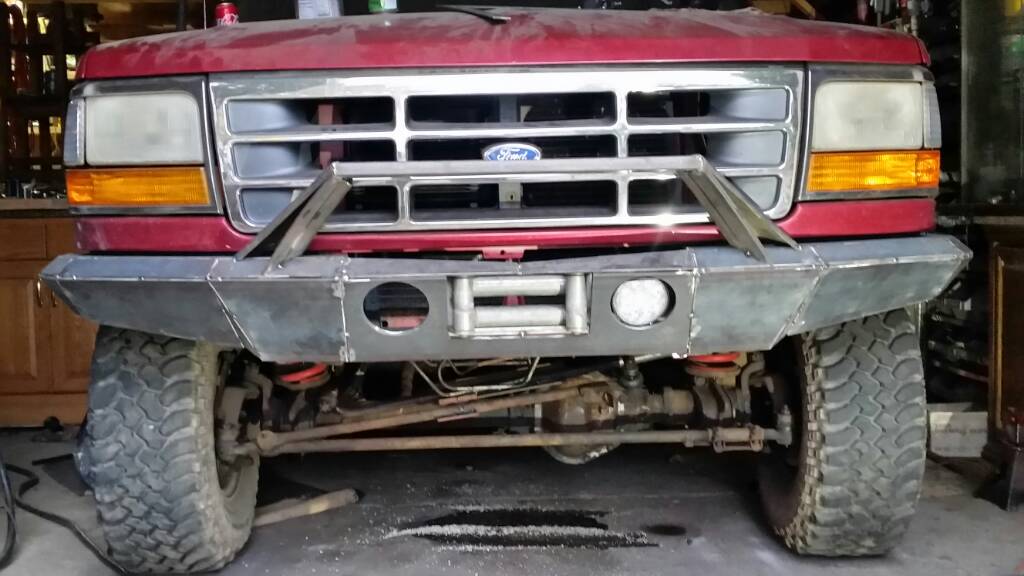

View attachment 14060 View attachment 14060 View attachment 14061 View attachment 14062 View attachment 14063 Heres some photos of the one i had fabbed up. I had space left open for some KC C series led squares for some rear facing lights. the open tubed ends double as steps and points to wrap recovery straps around. Then of course line xd the whole thing.

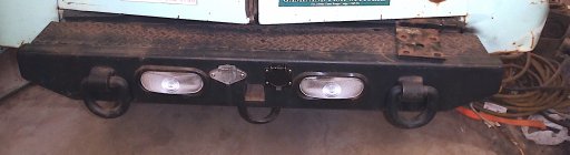

I hope it's ok to reply to an old thread instead of making a new one.
I needed a couple of bumpers on my Willys for a 2 week trip to CO. I had a piece of 2X6 1/4" wall tube and use that to whip up a couple of bumpers, they each have 2 D rings that are reinforced and in line with the frame rails. The front bumper is also an air tank, has a winch mount and 2" receiver built in and holds 4 lights. The rear has a 7way RV plug, a 2" receiver and back-up lights.
I realize they're not as cool and they don't have the new generation lights that are out now but they have worked well for over 25 years and 100K miles.
