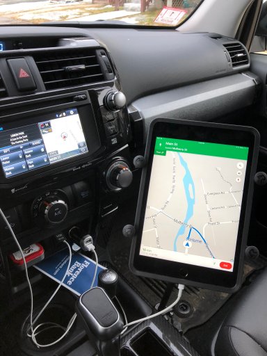

So it is all installed and works great. Took my 4Runner out on snowy trails and bumped along without any stability issues. Currently have the iPad plugged into a 2.1A charger and it holds a charge perfectly. As for the charging cord, I wrapped it around the arm a number of times so it no longer gets tangled.
My girlfriend often rides with me and it is our daily driver and she is not bothered by the mount. When you do not have a tablet installed there are enough articulation points in the arm to fold it away from the passenger side. Additionally you can unscrew the arm from the mounting points with ease. As far as mounting, I used sheet metal screws and they went in easily to the plastic by the 4 wheel shifter but took a little more force to properly install through the carpet and metal (for the lower mounting point). I have yet to put nuts on the back and I am thinking that I will also put some marine sealant on as well to prevent rust.
For those of you who are interested, here is the part list along with pics of the assembly and installation.
UNPKD. RAM 2 7/16" DIA.BASE WITH 1" BALL, Part ID: RAM-B-202U, Qty: 2
RAM PLASTIC DBL SOCKET ARM B BALL A LNG, Part ID: RAP-B-201U-A, Qty: 3
RAM BASE WITH 1/4" NPT THREADED HOLE, Part ID: RAM-B-218-1U, Qty: 1
UNPKG RAM DBL SOCKET ARM B BALL C LENGTH, Part ID: RAM-B-201U-C, Qty: 1
UNPKD RAM RAIL BASE W/BALL & ZINC U-BOLT, Part ID: RAM-B-231ZU, Qty: 1
X-GRIP UNIVERSAL TABLET HLDER W 1" BALL, Part ID: RAM-HOL-UN8BU, Qty: 1
1/4" X 9" LONG PIPE NIPPLE ALUMINIUM, Part ID: RAM-PA5409, Qty: 1

That looks *solid* @Zack! Very similar to the one posted here by @Lifestyle Overland last year (https://overlandbound.com/forums/threads/overland-ram-mount-solutions.5752/)
I'd seen versions with the added second RAM mount on the side of the console, and just received my additional pieces yesterday. I also ordered a longer 12" pipe, as I found the 9" too short with my iPad and 7" Garmin mounted.
I have an assortment of arms, so it should be easy to swap in different lengths to change the angle of the tube for different uses. I also have the double head like in Kevin's link above, which makes if pretty flexible (as in use, not sturdiness.)
Thanks for the photos and parts list.
Zack
@Steve - yes I saw what @SwellRunner and @Lifestyle Overland did and I basically combined some of their best ideas. So what I installed is definitely not unique. As someone with basically zero experience with working on cars, this was an easy and sturdy install.
Yeah, I like the 9" pipe for the timbering but the thought has crossed my mind that a longer one may be helpful in the future.
