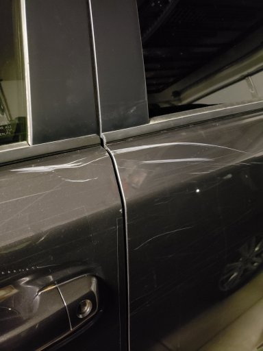

Besides having a professional buffing to the rig to get rid of the scratches and Desert Pinstriping, I am hoping someone has a better solution than the attempts I've made. I know it comes with the territory but I still would like to keep the rig looking as nice as possible.
first was the Turtle Wax product.....didn't work so well
Second was a compounding rub...worked better but not great
After a trail run this weekend and then washing the rig, the pinstriping reappeared.
So any suggestions would be greatly appreciated. ...and you can make funny comments also.. I don't mind. :sunglasses:
Thanks
Thanks
The only solution I found that works is using a random orbit polisher with polishing compound followed by the use of a poly wax (for durability) with a top-coat of soft wax (e.g. carnuba wax). Random orbit polishers won't leave swirls and are safer to use than non-orbital polishers. Use a good quality pad designed to be used for polishes. Start with a more coarse polishing compound to remove the deeper scratches followed by more fine polishes. You will likely need at least 3 different levels of coarseness to correct the finish. Do not use the same pad, restrict the pad to a single coarseness of polish. Finish up with a poly wax to seal the finish and a coat of softer wax over top to fill in any micro scratches left. I use Griots products and have been very satisfied with them. Once you have corrected and protected your finish you might want to consider providing a durable film such as 3M clear protectant film to the most exposed areas. The film will last for many years and can be easily removed.

I have used one product since the mid 70s with great satisfaction and with great results. For a while the product was really hard to find here in the east, so when I did find it I bought an entire case. I've one can now and when it is gone I'll just buy another case, should last me the next 30 years again. The product is TR3 Resin Glaze. If your scratches are a bit deep then first use Meguiar's scratch remover, with ample coatings of TR3 afterwards... These two products combined with a tiny bit of elbow grease will keep your rig looking great for years. I stay away from electric buffers and any "wax" products. Tis a shame you learned the hard way that Turtle wax is junk. I considered the 3m protective film only briefly. I'll stick with my method instead of spending a lot of bennies on something elbow grease will fix.... Rub On, Rub off. (lol) The bottom cladding on my rig is easily touched up using a custom match to Rustolem's "espresso" color. I simply roll it on as needed with a mini foam roller. The bumpers and rocker rails are SW semi-flat black and when they get beat up I simply touch up the offending area.

I've had great luck with meguires ultimate compound followed up by the ultimate polish , a random orbit buffer with a good quality cover is your best friend . tr3 is also a great product for protecting the paint

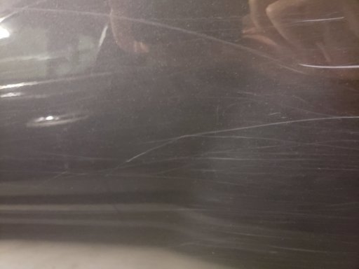

Though the pinstripes on mine aren't quite as bad as what you have pictured, I left them. Only time I see them is when I wash the truck :D and I don't like looking at them.
I think we both have the same color 4R; only wished I had gone with a lighter color (if one in Quicksand had been available) as the dark color shows off every mark and swirl.
very true about any dark colors... the sand color is very easy to maintain.
