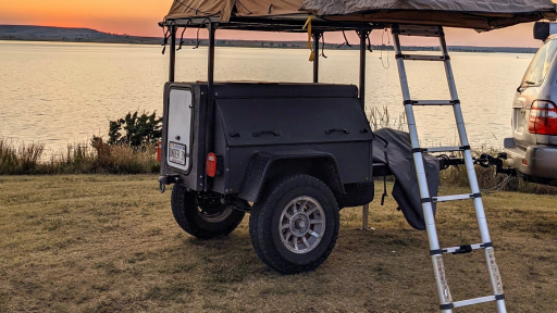

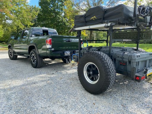

Hey it’s a great way to get ur RTT out there for base camp etc. this is my modular build. we overland off grid and high clearance. Used my old utility trailer as a base.
Reactions: El-Dracho
pa10spro
PA
Mark
Townsend
21073
I picked up a good condition used 4x6 utility trailer for $100 and turned it into a camping trailer to put my RTT on. Started with cutting off factory fenders, flipping the axle, and building the rack.

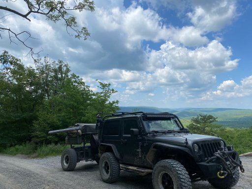

Hey. I am doing a similar build. Did u swap to a different axle? I am looking at timberlen axle less set up. Any advise after your project?
Yes. Put on a timberlen set up. ALS an articulating hitch. Did great on the Tat and high clearance trails.

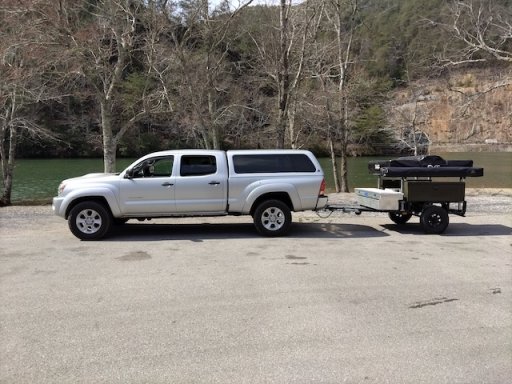

Nice trailers fellas!! Just finished up a build like this myself. Only have 2 trips 3 nights on it. Extends up about 28" from the travelling position. Only 13" tires on mine, might do bigger tires to match the Taco some day.

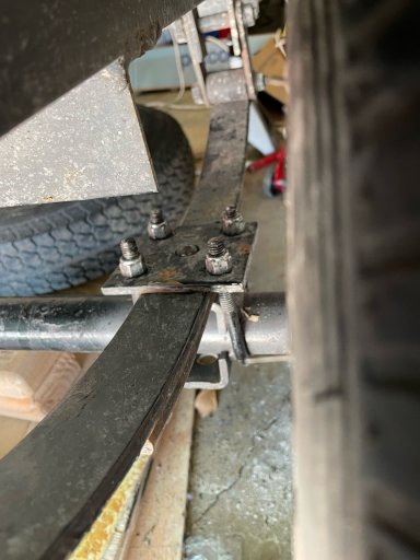

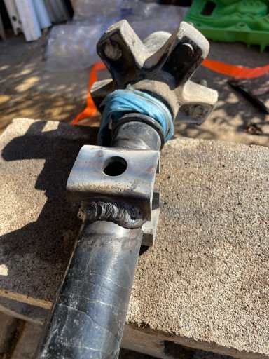

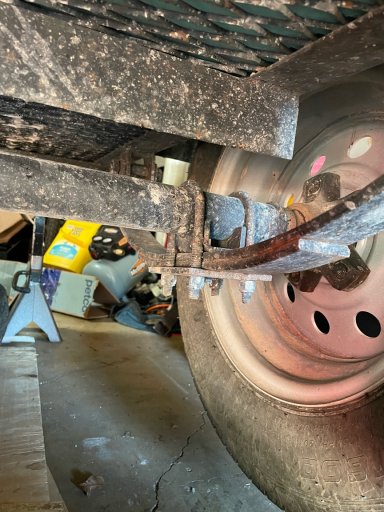

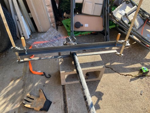

You can literally flip a flat axle but most trailers have tensioned axles. To do it right, weld on new mounts to maintain original load bearing angles. It’ll also chew up tires on pavement if you don’t.
Here’s some before, after and process pics to illustrate.
