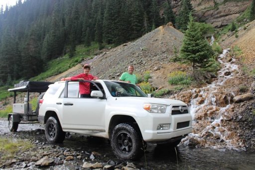

Hey it’s a great way to get ur RTT out there for base camp etc. this is my modular build. we overland off grid and high clearance. Used my old utility trailer as a base.

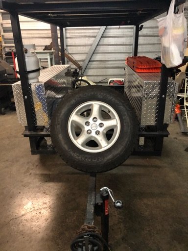

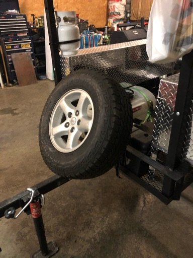

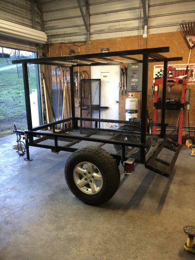

Yes. Put on a timberlen set up. ALS an articulating hitch. Did great on the Tat and high clearance trails.Hey. I am doing a similar build. Did u swap to a different axle? I am looking at timberlen axle less set up. Any advise after your project?I picked up a good condition used 4x6 utility trailer for $100 and turned it into a camping trailer to put my RTT on. Started with cutting off factory fenders, flipping the axle, and building the rack.

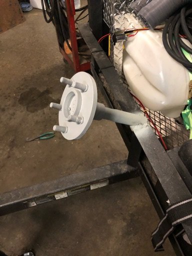

It isn't a recommended technique for those who carry higher loads since the axles are meant to be loaded in only one direction. If you look down the line of the axle, it has a bend to it to account for load (you can reweld the porches to maintain orientation).Wow, you guys have given me some great ideas on how to do my own utility trailer build. I currently have a pretty nice 5' x 8' utility trailer I use for various chores and hauling my ATVs. I'm going to look at using Superstruts to build a frame I can mount my RTT on and still have the ability to use the trailer for hauling chores if need be. Question, what are you guys doing to get more clearance with your current axle? My trailer has 15" wheels and I've seen you guys talk about "flipping the axle", what exactly does that involve?

It really depends on your wheel and the wheels hub opening. I run a Jeep "Turbine" wheel with no spacers on my Dexter 3,500lb axle. The "Turbine" wheel hub is big enough to let the trailer hub pass through.One more question, what size wheel spacers did you have to use to account for the backspacing?
