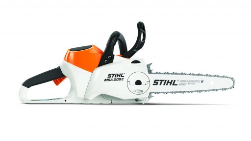

I picked up a Stihl MSA200 battery powered saw this summer. While it will never replace my larger gas powered unit it has proven its self to be a solid little saw. Plenty power enough to cut much more that the 12" bar can bite into. (A 14" is available). I used it once on a trail maintenance day and the battery held out for all I needed. Dozen or so trees. Its light, quiet, does not stink up your truck with the smell of fuel. Would cut firewood all weekend long camping I'm sure. And now it's the saw I grab around the house for a quick cut. Days where I'm harvesting firewood it stays home. Downside is price. Only time will tell if it's justified.

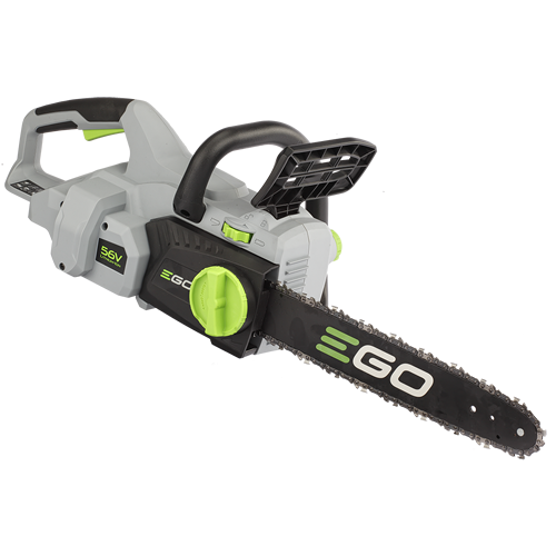

I noticed this saw at the Home Depot. EGO CS1400. $199. Much smaller investment if someone simply wanted a camp saw that would handle some tree removal on the trail too. HMR Depot has about a dozen different small battery saws online actually.

Ryobi has battery powered chainsaws available that utilizes their 40V and 18v+ batteries. They are offered in 10", 12" and 14".
Dewalt has two battery powered chainsaws. One has a 16" bar and uses their new 60V Flexvolt battery. The other is a 12" bar and uses the common 20V Max batteries.
Echo has one 16" bar chainsaw that uses their 56v batteries.
I mention these because if anyone uses any of the new battery powered outdoor equipment you can usually buy things as a "bare" tool. Where you don't get a battery. The lithium batteries are the majority of what your buying. And the technology is finally catching up with batteries vs. gas. Gasoline powered however will not be going anywhere anytime soon.

Yes, my battery was 40% of the overall investment. Saw/battery/charger. Variables are to be had. I got the largest battery and saw and the middle of ground charger. The entry level Stihl can be had for $300 with a battery and charger.
I think these are really good options for those who are looking for a trail saw. Less maintenance and cost. Will do the job of clearing and occasional obstruction. Need a little extra firewood done. (Please be responsible, down trees only where allowed)
On a side note mine seems safer to operate than my gas saw. I'm certain it will still take my leg off but the chain stops running faster when you let off the button. Still has a full brake. Plus it's way lighter. Shorter bar is also a huge factor. So definitely not an apples to apples comparison. I could definitely see starting my son (currently 8) in a few years with the battery saw.
