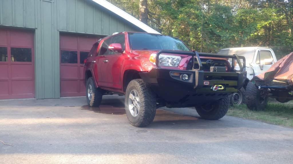

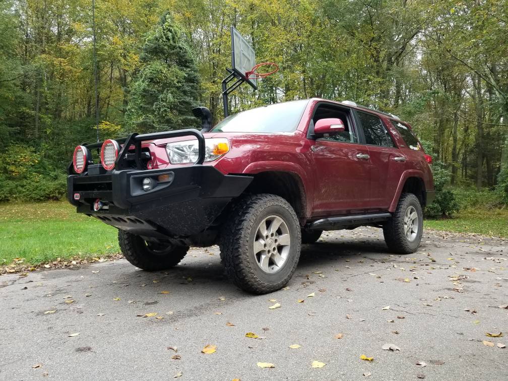

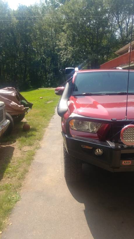

I figured I would start a new build thread for my current work in progress, my 2011 toyota 4runner SR5.
I've already done quite a bunch to it but still have a lot to do.

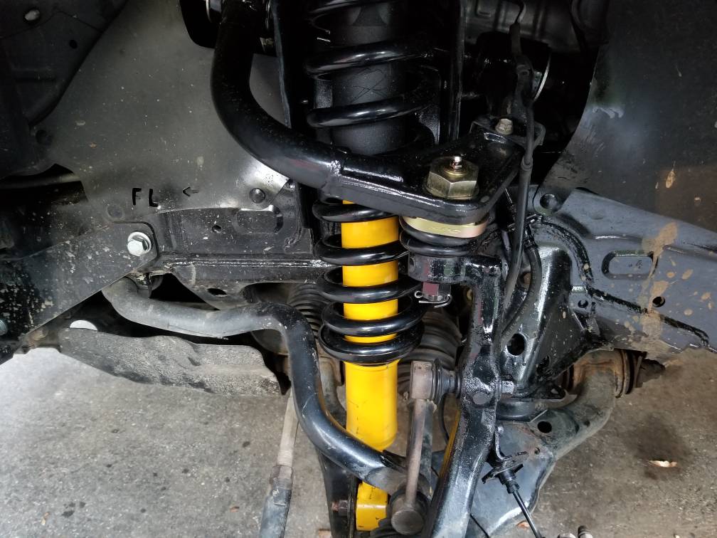

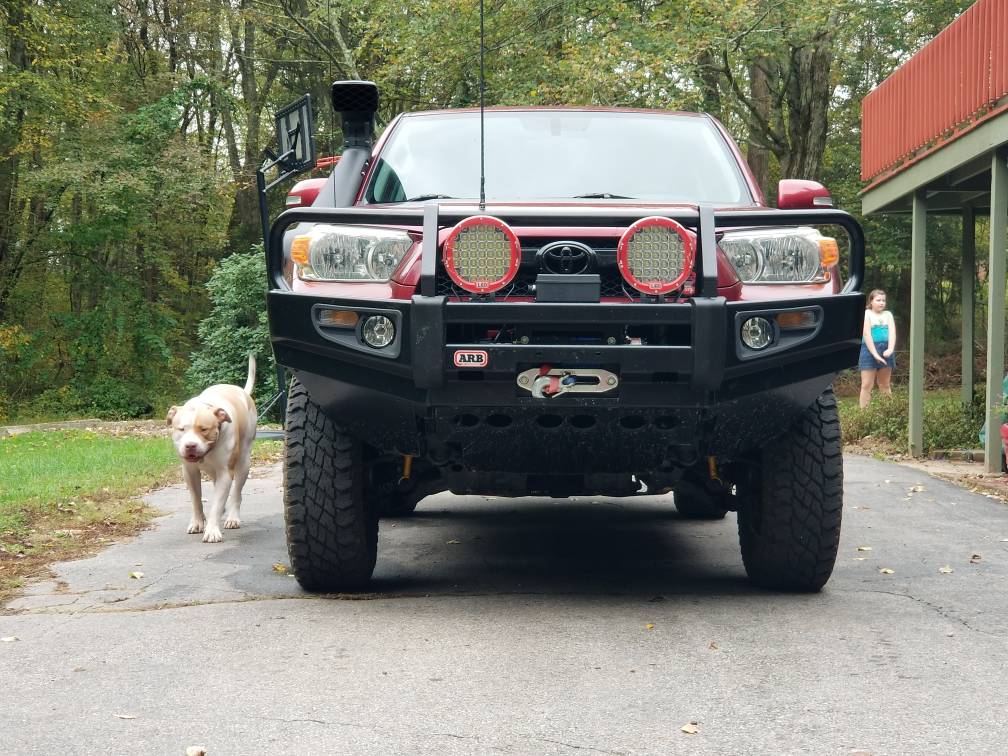

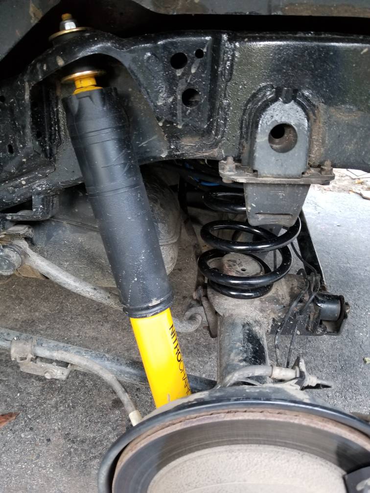

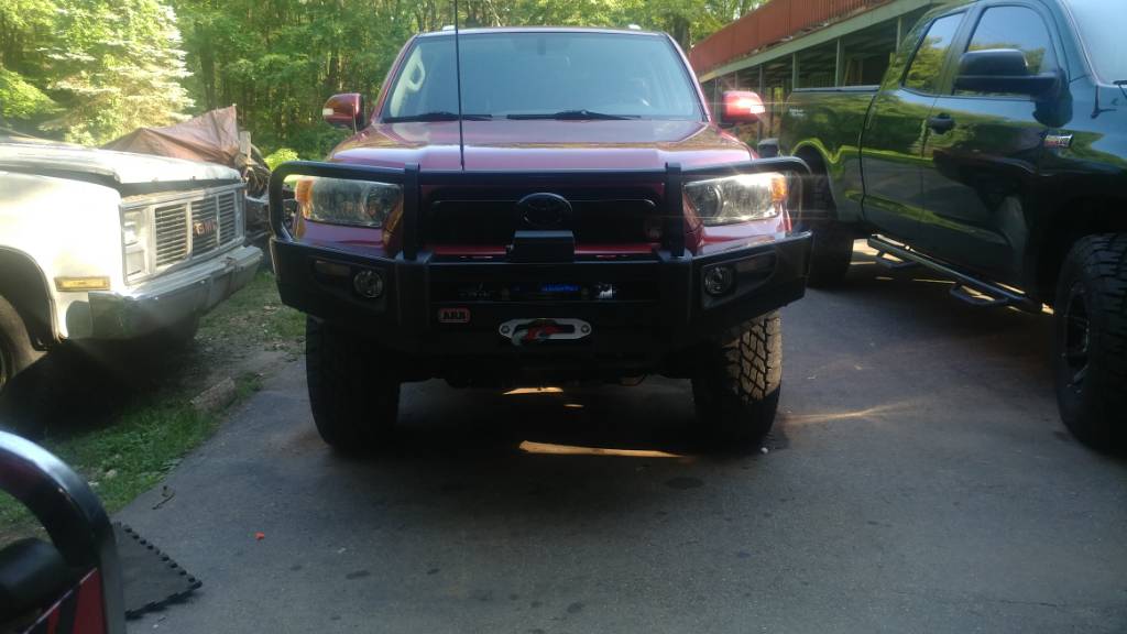

I have installed a supreme suspension leveling kit on her.(I just bought an ome lift for it, going on soon!)

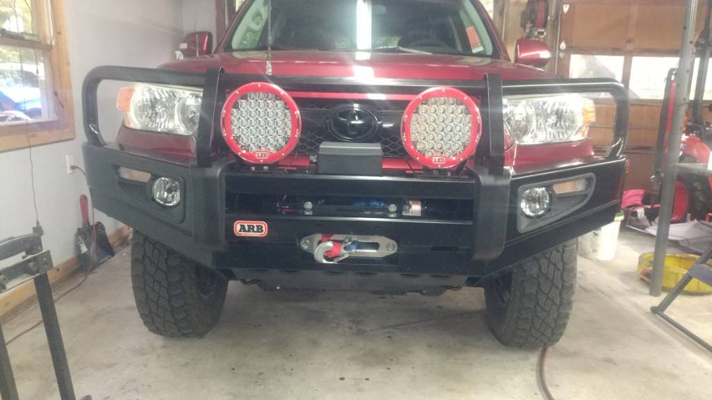

I also installed my new ARB bull bar and 12k winch! ARB makes one hell of a stout product!
Then I received my ARB intensity led lights for the front. These are almost overkill[emoji6] .

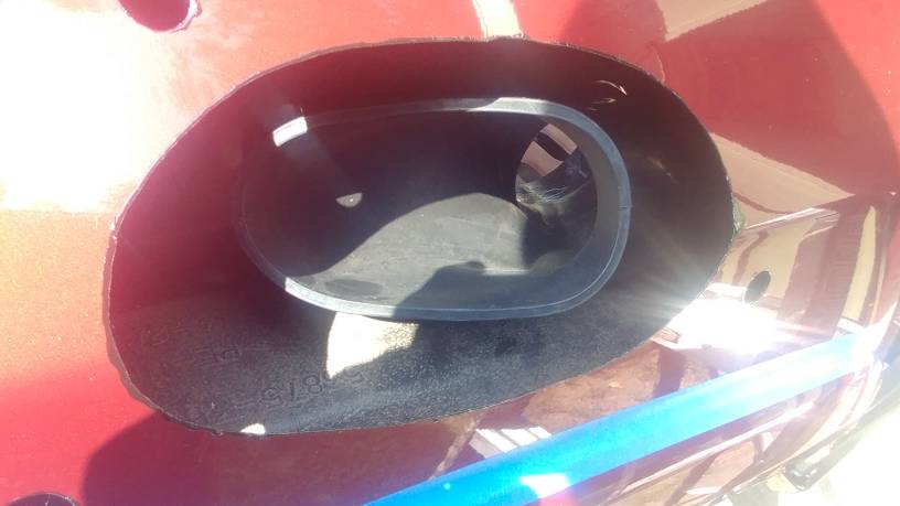

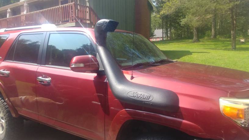

I have on order my ARB snorkel

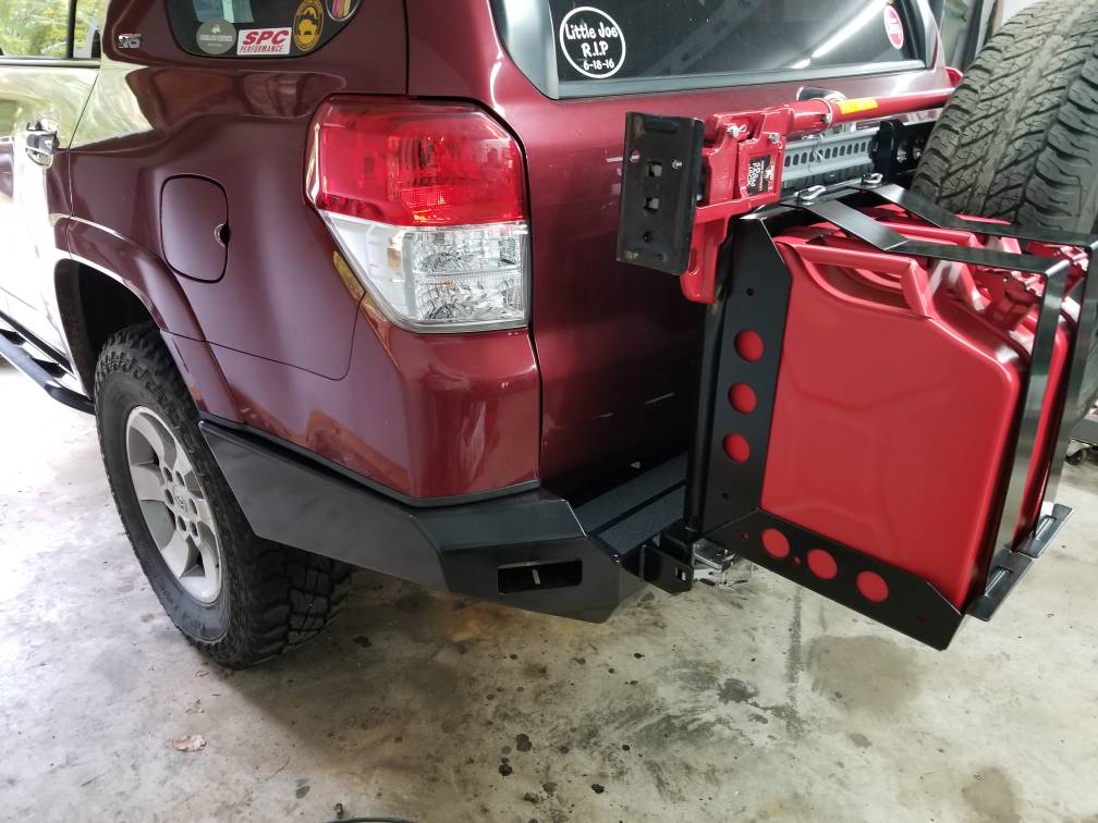

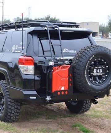

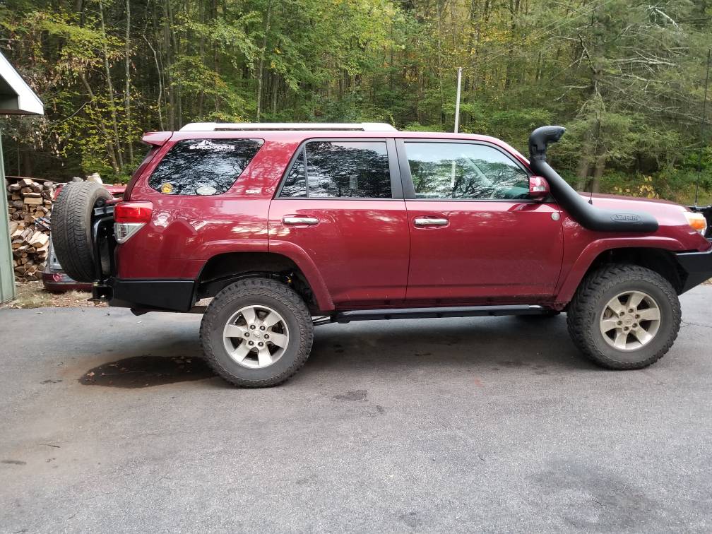

And my shrockworks rear bumper is on order[emoji16] with a sept 29 est delivery[emoji27] .

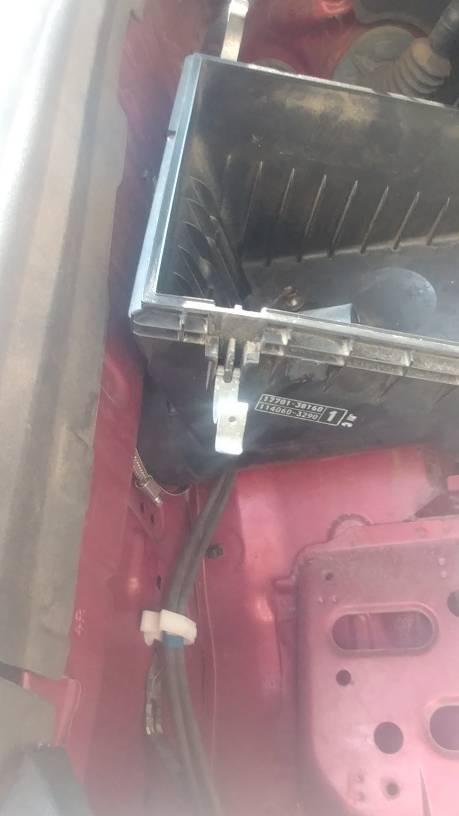

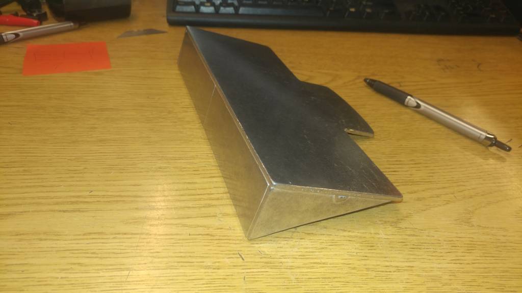

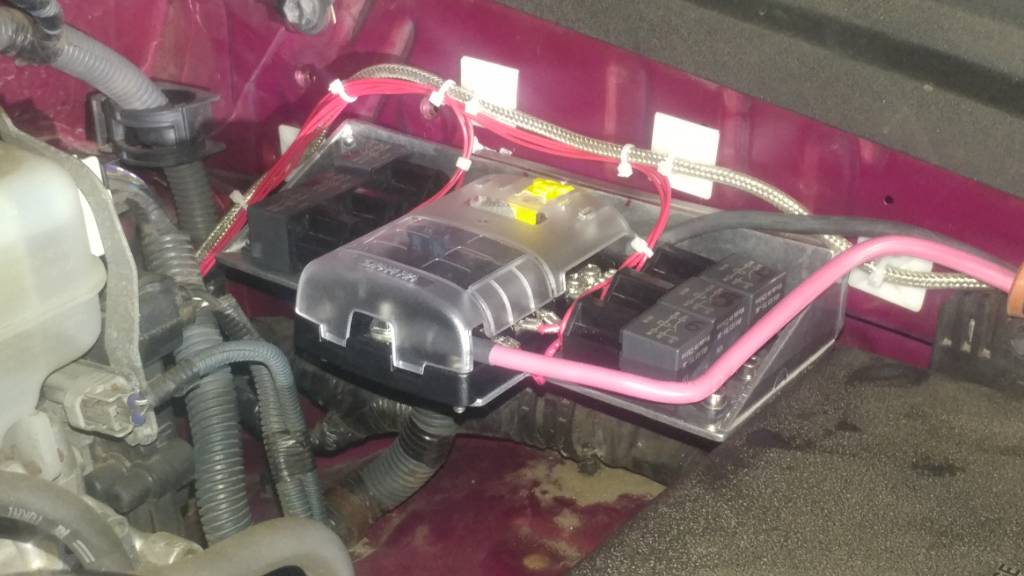

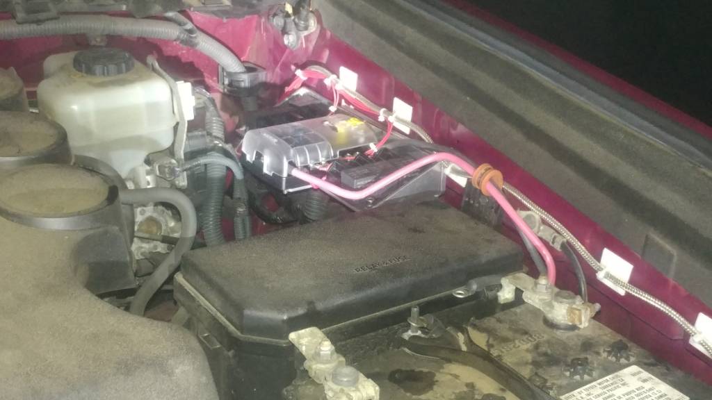

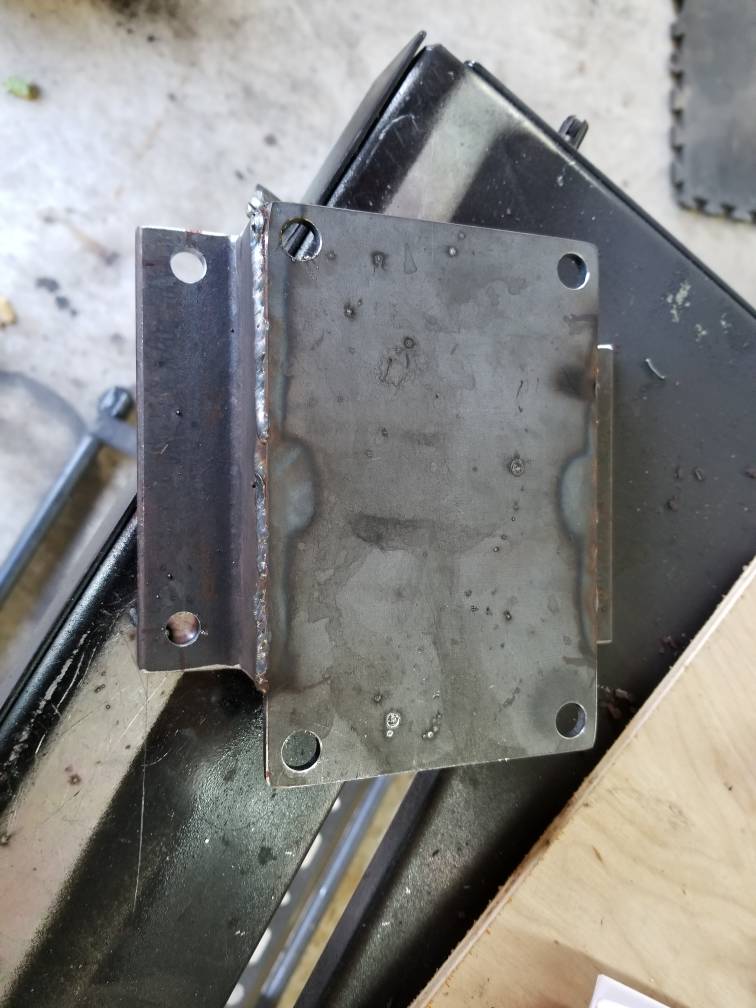

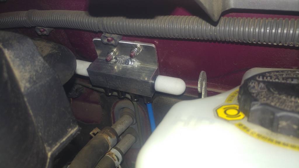

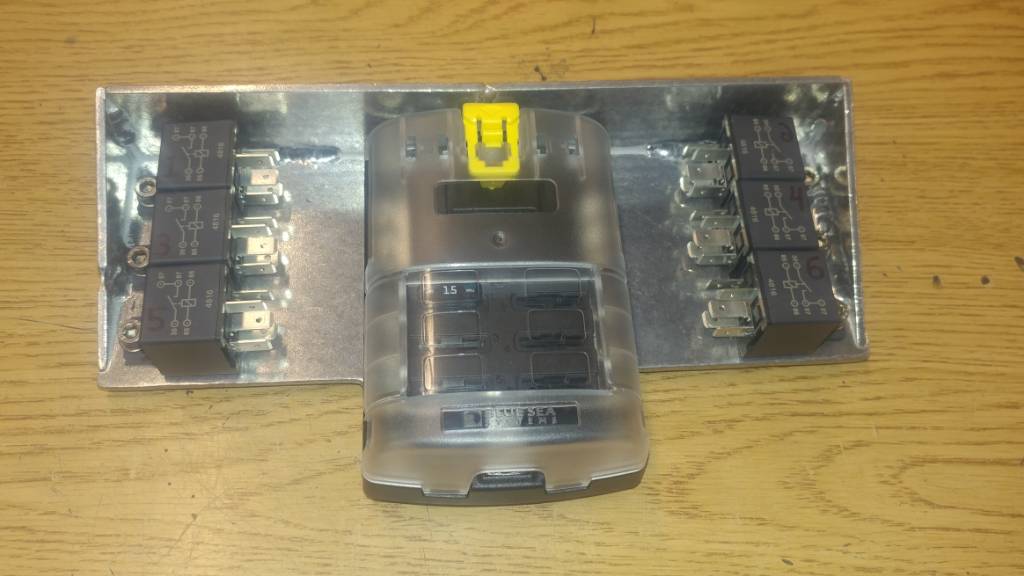

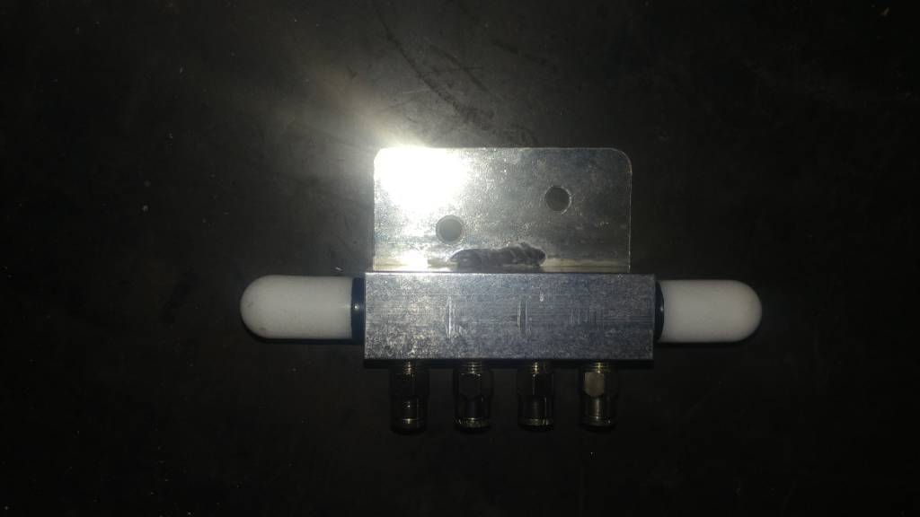

I decided to make my own power distribution center. I cut some aluminum and welded up a platform to hold the 200 amp fuse block and 6 40 amp relays.
All connections are soldered and sealed heat shrink. The relays are water proof hella units, very well made.

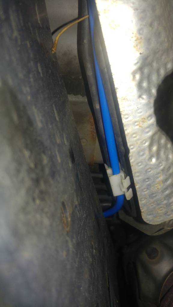

I sent signal wires up to my dash for the factory style switches I will install as needed. I only have the switch for the ARB lights so far. I now have reliable power for a fridge,more lights,power etc.

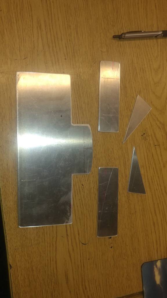

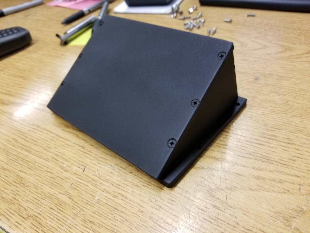

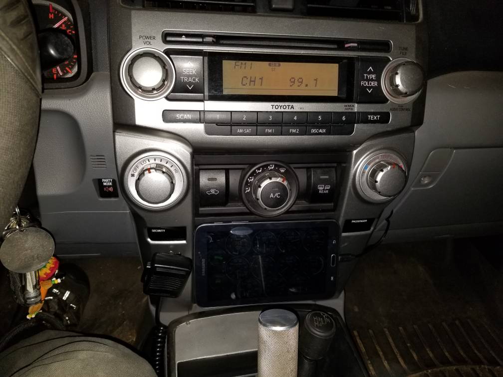

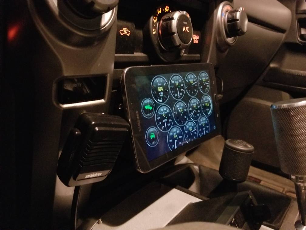

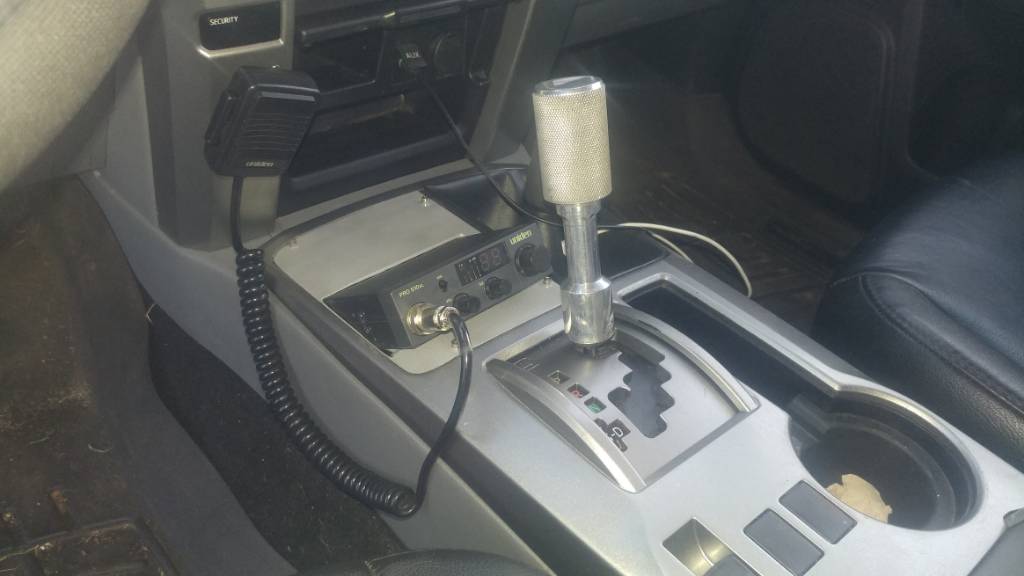

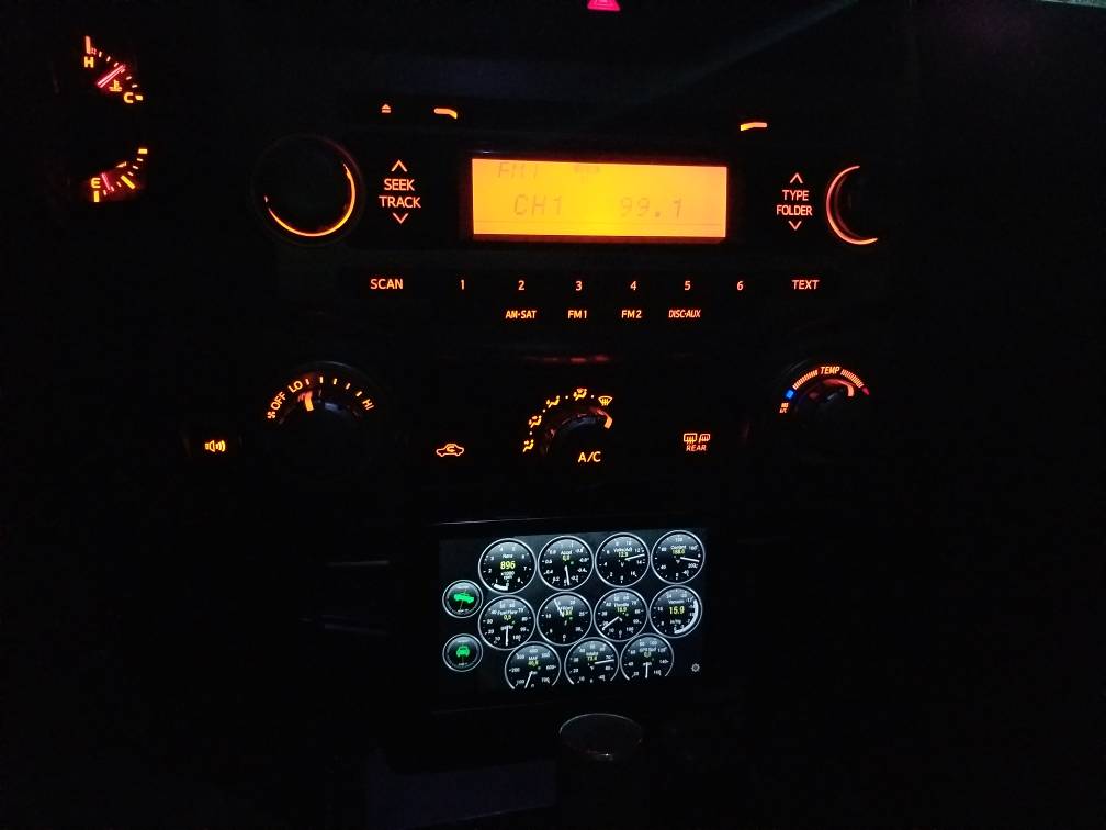

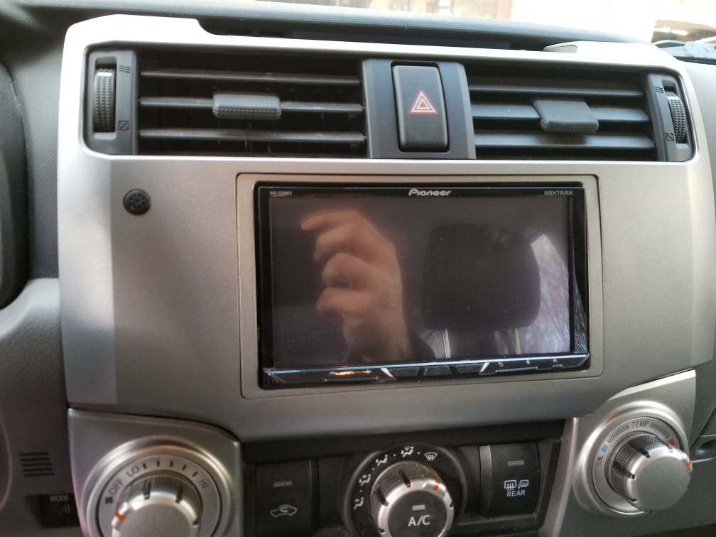

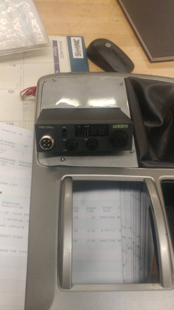

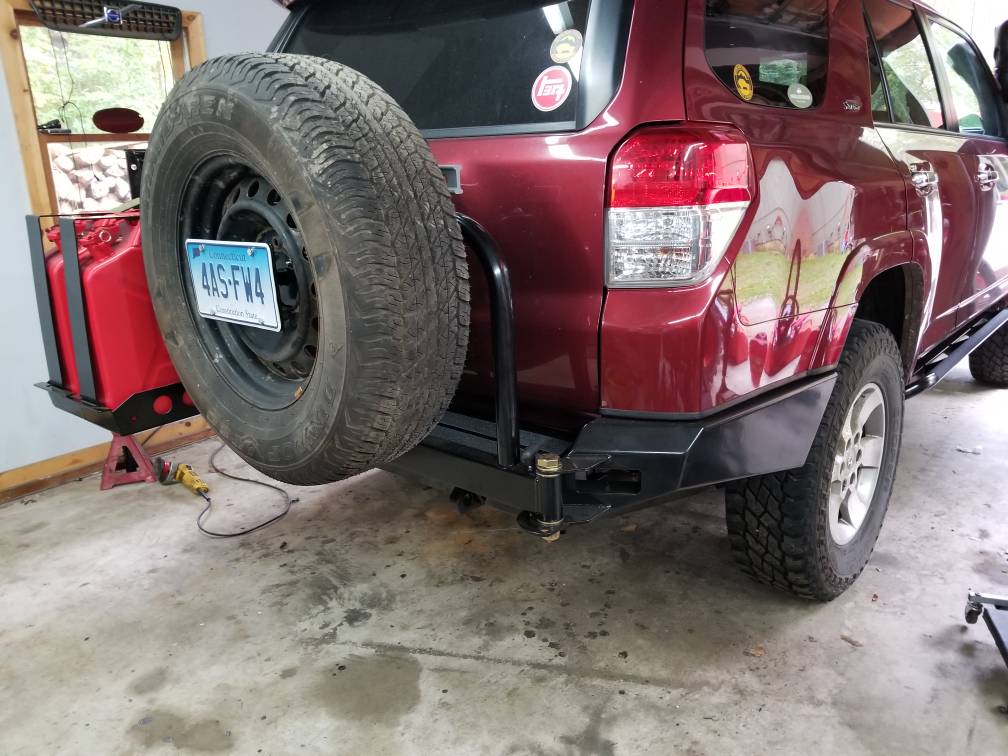

I also installed a uniden pro510xl cb. I wanted a integrated look and room is at a premium in my dash so I removed the forward cup holder and made a filler plate out of aluminum to hold the cb. Let me know what you think
