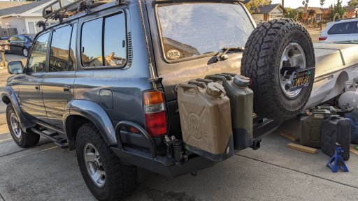

Personally, I normally bring 2-3 Wavian Jerry Cans mounted on my rear swing out. I have my fuel swing to the side my filler is on. I open carrier and just siphon the fuel without having to touch the cans. I don't have to worry about lifting and if I don't need the fuel it gets used any way.

I've stacked 6 on my roof rack, but it's not ideal. I finally built a swing out (novice welder btw) and carry the fuel there if I need to. How much I carry is dependent on how far between places to fuel up (or fuel up at a reasonable price per gallon....)
