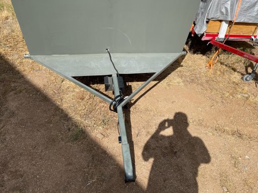

It looks easiest to just cut the tongue and move it to the other side. If your worried about the center bar loosing strength from not having it one piece, you could sleeve it.
As to your comment about grinding, have you tried ceramic disks? I get more than three times the life and they cut way better then anything else I've used.

I agree that cutting the tongue is the easiest way to do it and sleeving/trussing.

Most indipendent suspensions like this do have the piviot in front if it matters at all. This allows the trailer suspension to "slide" over obsticles rather than get "hung up" on them IE: rocks and logs in water crossings.
Having said that, this is a badass build.

I run my cooler in the rear to balance out my front. If you have your camber/toe set properly, you don't need much tongue weight, the trailer will pull straight. When I'm off road I run my tongue weight at zero. I move my tool bags to the extreme rear. Anything on the tongue levers the rear suspension.

I’m using disks like the one you show. For the A army’s I’m going to keep them the way they are. I’m not doing a Baja with it so I don’t think it’s going to be an issue. If I do see it hitting things I would test out nylon sliders.
Its not a baja thing but a math thing. At least at this point if it works, great and if it doesn't at least you know what you need to do.

i can only see that suspension being a problem offroad.. onroad it should be ok as long as you put limiting straps.. I really feel you are going to swap that suspension around so it is a trailing arm. working on my own trailer at the moment, however I dont have all the tools needed... but I have a buddy with a welder, the rest I can make happen. mine started life as a Police radar trailer... my trailer build

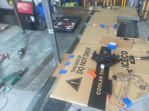

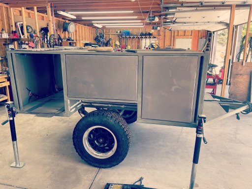

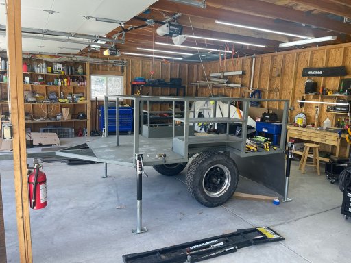

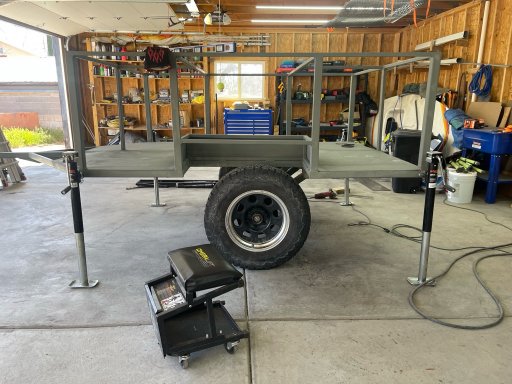

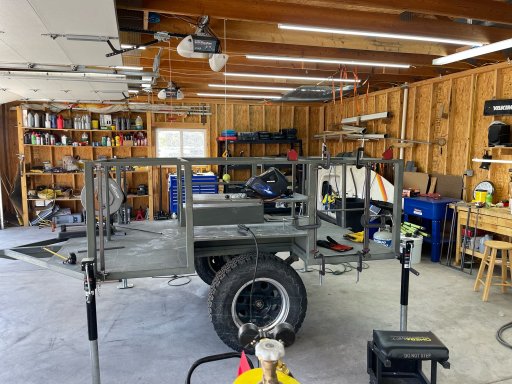

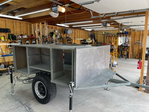

Thought I posted these pictures but here we go. I have this weekend away from it due to other things that need to be done in life but next weekend more to come.

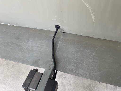

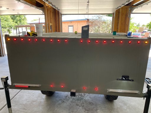

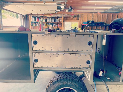

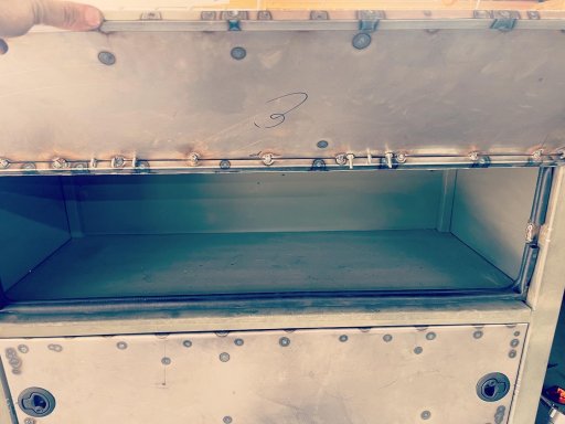

Hint running wires is going to take a long time. Harbor Freight has a spot welder for $175 240V don't forget to get a plug for it. Yes, it does come with the wiring but no plug go figure. The doors I started came out better than I thought they would.

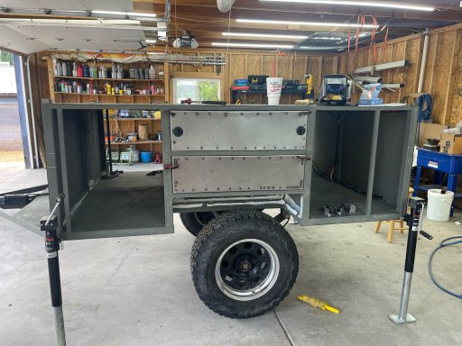

Why is it the smaller tasks take more time than others? The electronics and kitchen doors are done. Ok not fully done but you get the idea.  electronics and kitchen doors are done.

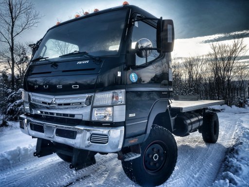

I feel your pain. I’m ”Built not Bought”-ing a sub-frame, flat deck and full habitat box for our Fuso FG - I’m over two years into it and it still looks like nothing. You’ve come a long way in a short time! Took me over a year just to get the truck ready fir the sub-frame, and it’s been a year since I started the sub-frame and flat deck. I am almost to the point of being able to put up the walls for the habitat box, but then have the whole interior to do.
If it ever feels like it’s going slow for you, don’t worry, it’s going slower for me!
Hang in there, you’ll get there, and it will feel good when it’s done! 576DEC2E-7A27-4D62-AAB3-979A188A595F.png73AE8CEA-30F2-4582-ABA3-E41A9976B7EB.jpeg
