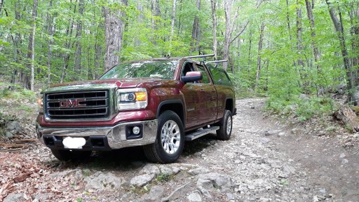

Nice truck! Good truck. I'm not sure where you are going that you are bottoming out on fire and logging trails. Maybe you are more adventurous than me.
I have the Bilstein 5100's at the top setting and I like it. Only the fronts have that adjustment, so if you get Bilstein 5100's at all 4 wheels, only the fronts adjust, so that IS a "level" as opposed to an all around lift, which lifts the rear up a little as well.
The Bilstein rear shocks will handle some lift as well, but only 1 additional inch. This is done by replacing the factory blocks at the rear with replacement blocks that are 1 inch taller than the factory ones. I have not done my rear but I'm thinking about it.
I'm not sure they are built for anything more than trail riding, though, so I wouldnt go rock climbing with them.
I dont have pics that really highlight the stance with my Bilsteins. Maybe I'll take some tomorrow and post
Mainly washed out FS trails and mud holes on those trails is where i get into problems. My front license plate was just under the winch and it got ripped off somewhere last trip. Couple inches lift will hopefully help.

Yeah, I'm at 3.42. Really a 32 inch tire is pretty good. Mine aren't even that tall. Dont forget, getting a tire that is 1 inch bigger will only gain you a half inch of actual height. So spending $ on 33's (or 35's and regearing) wont get you much at this point compared to leveling off the front. The front Bilstien 5100's are about $100 each.
I dont know Fords like I know Chevy. My truck has coil overs up front. If yours does too, then pay to have these installed. Unless you are a professional mechanic working in a shop...PAY to get the fronts done. It still cost less than new tires. Believe me, taking that coil spring off the shock was so hair-raising, I was bending the spring compressor. I finally brought it to a shop, and even they had to be careful. So plan on spending a few bucks at least to have the shock mounted inside the spring.

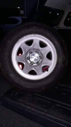

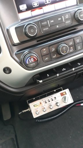

For me it's less than that. Diamond deck tool box, front level and rear shocks (Bilstein 5100's all around), used Leer camper shell, used Trac Rac roof rack, some lighting (which I've yet to install!) And I just picked up the Chevy/GMC 7 spoke steel wheels on which, in the not too distant future I want to mount whatever 33 inch tires I decide. I already have the coolers, camping gear, tools, FRS/GMRS handhelds and CB
