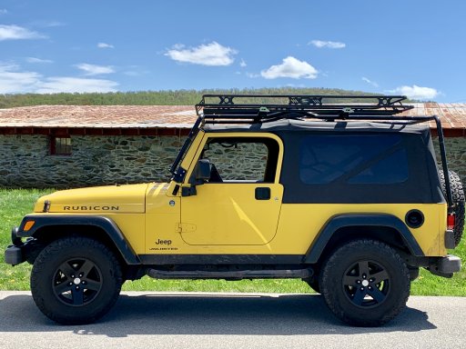

Here’s mine with a TJ heavy duty OME lift, Savvy 1-1/4” bodylift running 33x10x50R15 BFG KO2 tires on stock TJ rims.
It actually isn’t too bad with the stock 4.10 gearing as well, if I make the jump to 35’s I’ll defintely regear to 4.56 or 4.88’s.
I couldn’t be happier with how everything performs, the on road ride is firm but not harsh. I initially regretted getting the HD kit but after the first trip offroad I am pleased I did, especially if loaded for camping. If I ran the soft top with no rear seat I would probably get softer shocks.
The combination above is absolutely dramaless on road, no following the cracks or twitchiness and it drives about as good as relatively stock TJ can be.
Reactions: Graeman and PCO6
