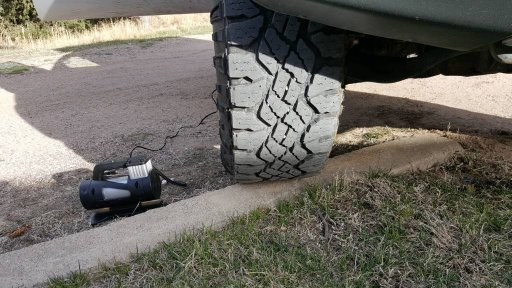

My brother runs c range and i run d range. His rig weighs about 5500lbs where as mine is about 4800lbs. He gets the same tire spread that i get if he runs 20psi and i run about 16psi..the lj is light but i would think you'll only be a few hundred lbs lighter than my rig when your on an expedition.

Thanks for the reply. So you do have to go lower pressure on your D rated tires to get the same foot print as your brother on C rated tires. My concern is that I can only find E rated tires in 33" on 16" wheels (285/75-16). In order to keep a 33" tire and get a C or D rating, I have to change to 15" wheels which I'd rather not do.

Same vehicle weight would dictate lower pressure for same footprint however different tires will flex differently at each psi depending on tread compound and sidewall plies. I ran fins and things in moab with 33 inch duratracs at 25psi just fine. I can drop psi in my duratracs and post pics of the sidewall flex for you when i get home. Just tell me what psi you want pics at...

So I'd like to see what kind of foot print I could get out of about 15psi given that's probably as low as I would want to go in normal conditions. One of the people I was off-road with this past weekend has the 285/75-16 (E rated) KO2's and when he dropped to 18psi, there was barely any visual change in his tire and I noticed they didn't flex much over rocks. My junker C rated tires were also at 18psi and there was a very visible change in foot print. It also made the ride significantly smoother on the pit-run.

Yet again, thanks for the great feedback and pictures. I think I may be sold on those DT's. They really seem to be holding up well! I'm really trying to figure out if the taller lift is really necessary. The more I see and hear, the more I think the 2" lift with 32" tires is going to be more than sufficient for me. I can always upgrade to 33" tires by adding a little body lift later. I need good, predictable road manners as my wife will be driving this during the winter at times.
