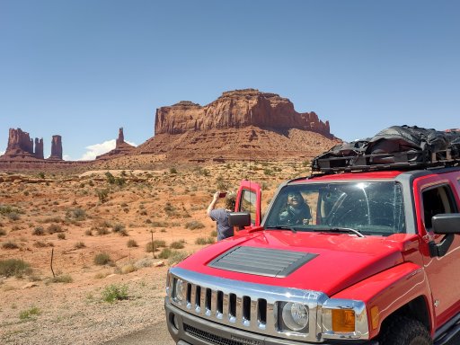

I found myself in a similar position burying the pandemic. I got T-boned hard enough to roll me over. I fortunately want to wait fine but the rig I spent 14 years developing and perfecting was totaled. Being a 14-year-old vehicle insurance company was less than generous about what it was actually worth. This left me with a little less than 10 grand to find a replacement and get back to what I love doing.
My last rig was an 07 Xterra with the OFF ROAD package. If you can find a second gen Xterra with the OFF ROAD also rebranded as the PRO-4x4 package I would grab it. They are mountain goats and can go anywhere. I did very minimal mods to it and it was great. Easy to work on and with so many Xterra around parts are easy to come by. This package includes better suspension, 4wheel drive with a rear locking diff and good amount of under body armor.
Unfortunately I couldn't even find one that was within 1500 miles. So I had to broaden my search. I eventually ended up landing on a Hummer H3 with the adventure package. It is a 2006. I have been happy with it so far. I have finally fixed all the little annoying things you find with a used vehicle to get it to what I feel is up to mechanical snuff. At first I was worried that this being a limited run vehicle and such an old vehicle I would have a hard time getting parts for it. The drivetrain is GM all the way so engine type stuff is easy. Some of the plastic parts and specific body parts to the H3 are a little harder to find but there is a great online community representing these vehicles a wealth of knowledge that makes working on them easier.
If you're going to look for an H3, do a little research so you know what you are looking at when test driving one. GM did a bad job at marketing the different versions of this vehicle. The adventure package is basically the equivalent of a similar generation Jeep Rubicon. Depending on the year you'll get at least a rear locking diff. The later models have front and rear lockers. They also have plenty of underbody armor and a four to one gear ratio in four wheel low.
Good luck and let us know what you land on.

An H3 could be a cool option. I'm not sure on available maintenance parts though.

Maintenance parts for a H3 are a mix between canyon and trailblazer parts. Besides body panels alot of things under them are interchangable with the chevrolet cousins. They are great rigs but have terrible outbound vision inside the cockpit.
