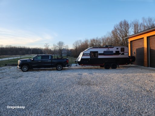

We just hit our 3 year anniversary of living in our HQ19 full-time. 0 issues since a couple small things at initial purchase. It's been an unbelievably solid rig. Year 4 will be touring the American West again.
Looks awesome we have had for few months and few trips will see. Yours looks like sits higher than mine. HMMMM
