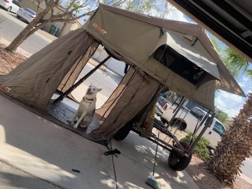

as I mentioned I traded a mountain bike for a trailer and roof top tent; A very gently used 23 zero tent and Annex. and the trailer Isn't much but its sturdy; but has some issues; we can go into them later.

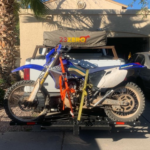

Now I am not a person who has the patience to take a trailer off-road; Two axles is plenty; on top of this the trailer was sturdy but needed some TLC; which doing an full trailer outfit and truck outfit seemed like double the work; So not going the trailer route. Also our starting platform wont run into the GVWR issues as fast as smaller platforms; Being an already bulletproofed 3/4 ton truck; we have a have greater capability for storage and hauling. We are going for a Mount, Romp, break, Upgrade, Repeat. Starting off we went for a less than traditional design of our rack; 2 inch square tube .095 wall. the design is a double layer design on the rack for two reasons; Protection for the tent from impacts and mounting points for things down the road as we build this rack further; we are fish mouthing the legs for strength and rigidity. down to 2 inch angle iron on the bed rails; we are mounting the tent at the height of the roof to save some headache from decreased MPGs and Low clearance areas be them on or off-road.

Now this design in living with it has some super apparent flaws I will point out later; weight is not directly one of them surprisingly;
here is the first big fabrication fail; measure more than twice before cutting; also my buddy and I are bad at Napkin geometry;
we wanted to Kickers to be at a 45 degree angle for maximum stability, but unfortunately we forgot how triangles worked we had our height and our angles we wanted; but clearly did not do the math right; so we went back to the drawing board on how to make the legs land on the 2 inch angle iron attached to the bed rails; this is a learning experience; ( Since then we picked up an awesome program called Bend-Tech and a tube bender; V2 is gonna be way better.... Moving on; we corrected the Legs by changing the angle of the legs from 45 degrees to 62 degrees; a whole lot of measuring, welding and beers later.... Version 1 is complete.
DCA97383-5797-4B66-8FB9-35CD625AB11E.jpeg 1037E05A-087D-48FB-A981-59C1D62F218D.jpeg
as you can see with the double Ring design we have plenty of room to mount things by the tent; such as an awning, storage boxes, Tools, Ect..
