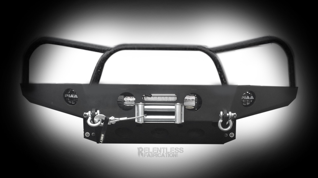

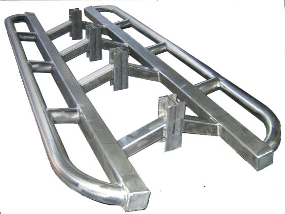

So I'm looking into getting some armor for my truck. Right now on my top priorities are front bumper and sliders. My question to everyone is which would you invest in first? As well for sliders would you suggest a kick out? How much of a benefit have you seen from a kickout? Thanks guys! These are what I'm looking at.

I would say if your doing a lot of rock crawling, or going to a lot of places with huge obstacles (like moab for example) sliders with the kickout. The kickout would aid in protection.....
But if your not doing that sort of thing the kickout could just be a hindrance.

Thanks goheels! I don't really do any rock crawling but I'm not going to say I won't in the future if I stumble upon it lol.
Thanks SLO Rob. I was more leaning toward sliders already lol. Unfortunately there isn't to many company's that make sliders for my tundra so I'm very limited to who I get to go with [emoji107]

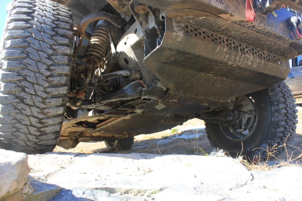

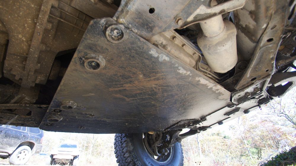

Bumper ought to far behind underbody armor. Radiator and engine skids are priority. Gas tank on many vehicles is vulnerable. You can easily be left screwed in the backwoods without such. Dont trust any factory plastic crap as i have seen them dent and puncture too many times. Sliders after that and bumpers once you have the rest protected.
For example I have most of the essentials covered with these three plates.

Making your own isn't all that difficult and could save you some $$$.$$.

I agree, under armor should be first. lots of vulnerable components underneath, don't let them be "out of sight, out of mind", it could cost you.
