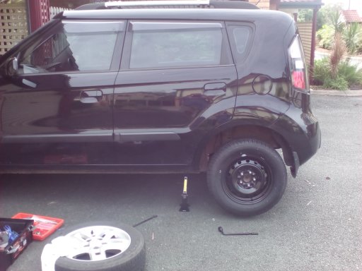

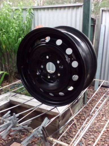

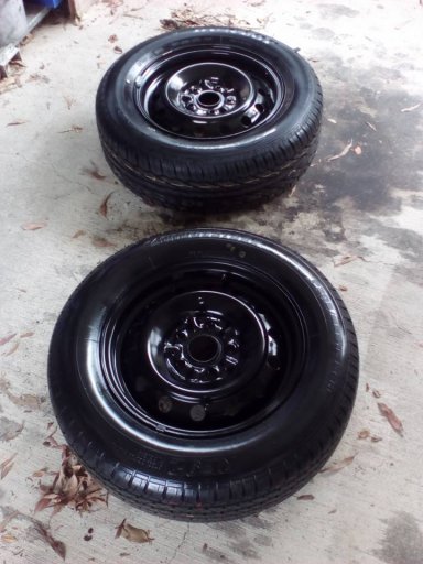

Hello all....since i have a small vehicle, tyres with an aggressive pattern are hard to come by....I ditched the 16" factory alloys and went with a 15" steel rim (ROH) to be able to run a taller tyre....205/65/15.
It appears only in larger diameters , that 65 series tyres are an option with aggressive tread ....let me know if you are familiar with any brands that cover the little guys ?...cheers
