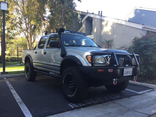

Great quality and fitment, you can't go wrong. The bumper on my Tacoma is Airbag compliant that's a great safety feature. I have heard the recovery points are for mounting a Hi-Lift jack, I have some shackles on mine for the look.IMG_0147.JPG
