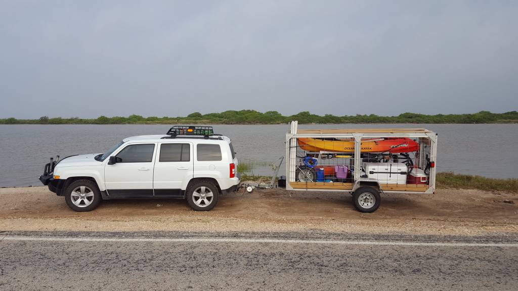

But yes, I've almost had my trailer tip. The only thing keeping it from doing so was the standard 2" ball.
The axle is a 42" and the box is around 52 inches tall with 3 deck boards on top and an elevated kayak bunk. On the bottom is a 4k generator, 7 gallons of water, class 27 deep cycle and a cooler with 50 pounds of ice... and I still get a wheel off the ground pulling up a steep, off camber embankment to get on the road.

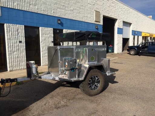

image.jpg My trailers pretty light unloaded, and i have a fixed rail for mounting my rtt. The floor of the tent sits about 6'-4" from the ground. I havnt had any tipping issues yet, though one time i was worried.
But an adjustable set-up is alot cooler!

Keeping a low CG was one of the main priorities when I searched for my trailer.
That 18" of height that serves no other purpose while traveling seems a waste.
I have had to do a quick lane change at freeway speed where a trailer that high (above pic) would be very concerning.
And some of the off-camber trails that I have run may also be a problem, not only the height, but the stuff that could run into trees, rocks, etc. if it were to stick up that high.
My box is low and my tent sits right on top of the lid, I feel like I've got it as low as I can.
Besides, I'm getting to the point where the lower the ladder is to climb into bed, the better!
