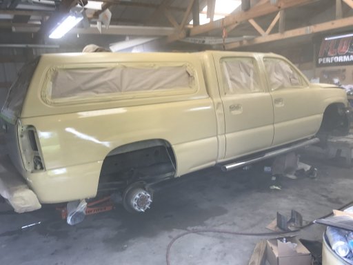

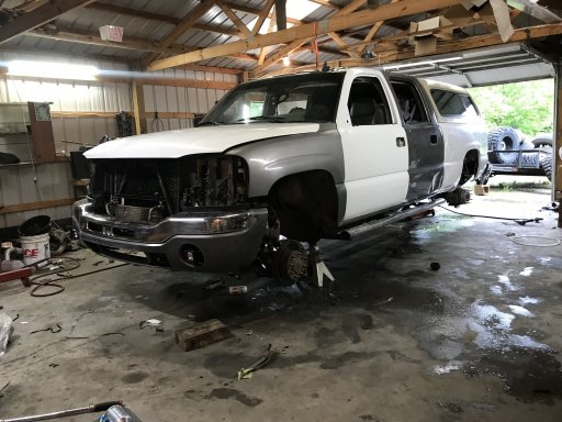

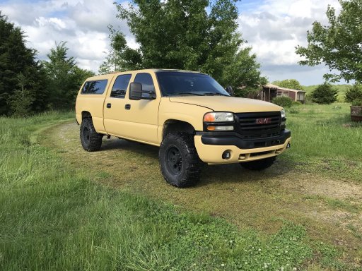

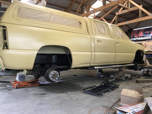

I did in my home shop. Single stage enamel, nothing special. But neither is the truck haha.
