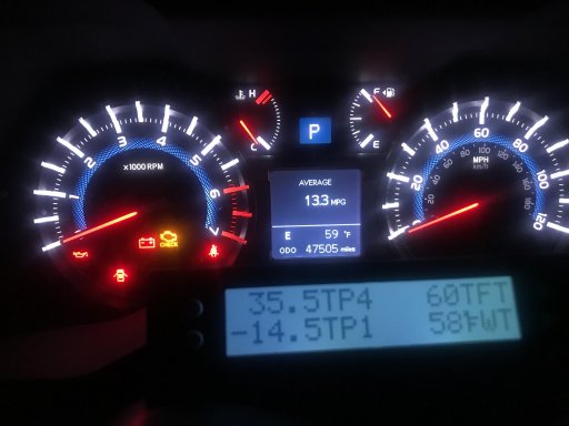

How much did your Gas mileage do after you when to the 33 inch tires (285) ?
Are they very loud on the highway ?

Mine now downshifts to 4th on nearly any hill on the highway, trans temp runs higher than it used too. I added a cooler. Tires are heavy, and the 4R feels it. I am looking at regearing differentials at some point to be honest. Gas mileage took a hit. I don’t really figure mine, as it’s our weekend car. But it did drop some no doubt. I’ll try to look and see what the dash says in a bit
As far as how loud they are. You can definitely hear mine. You can talk over them. But they aren’t quiet by any means.
imho if you’re happy with your stock tires, Stick with an all terrain and look at the tire spec sheets to see which ones are lighter. A heavy tire is harder to turn, mind you they are typically stronger too. But lighter may not affect gas mileage as much.
