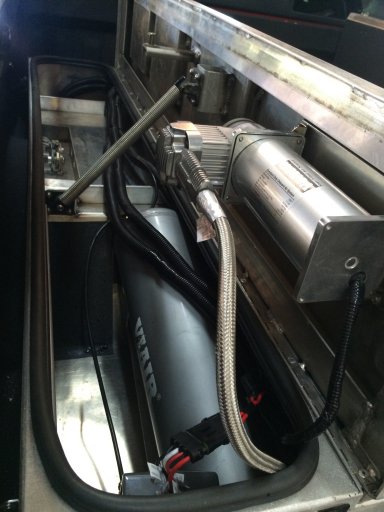

I run this same setup in my Power wagon. I added a second 2.5gal tank and yes you can run air tools and airing up 37's is a breeze. I built a frame to hold both tanks and the compressor across the front of my bed. I currently have a dedicated 35' "air up" hose with the locking air chuck. I also have a 50ft separate hose with a standard air chuck fitting for running tools or airing up others without having to turn vehicles around. I ditched the Viair gauge and switch for a column mounted MaxTow digital/analog gauge and added a dedicated compressor switch to my accessory panel. I plan on adding two more tanks and a second compressor to double the system capabilities as well as having the redundancy should a compressor fail.View attachment 29370 Love my little 100% Duty cycle Viair with the 2 1/2 gallon tank. It came with a coiled air line that i can easily reach all my tires. And i can run air tools with it too.
