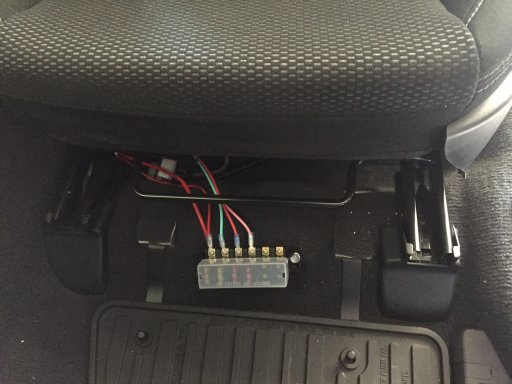

Forgot to add the photo of the fuse box and buss I installed for the CB and extra power sockets, it is located under the drivers seat so only needed the main wire from the battery to here to power everything inside. Still have 2 empty spots for future needs inside the cab. An additional power required for lights ... on the exterior will be handled by a new fuse box under the hood.
